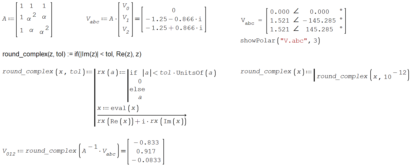

I am one tiny step away from freeing myself of Mathcad Prime. I just need to know how to format the result of a matrix/vector operation so it is in polar form with angle in degrees. The attached image is a snip from a Mathcad result. How is this possible in SMath?

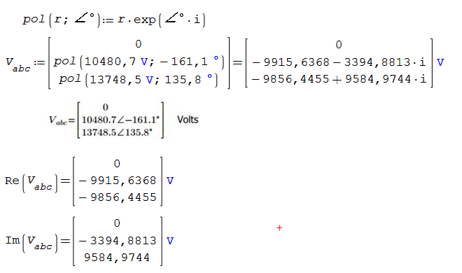

Thank you. That does not address formatting a vector result in polar with degrees (what I'm after) as best I can tell. I want to display my resulting vector in polar with degrees.
Also, I tested the "pol" function and it assumes the angle is in radians.
Worksheet1.sm (10,64 КиБ) скачан 1016 раз(а).

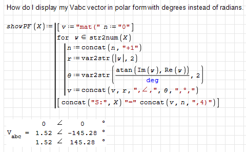

Hi. You can try something like this, using the table plugin.
showPolarForm.sm (18,3 КиБ) скачан 1050 раз(а).

Thank you. That works rather well.
1) Is there a way to hide that showPF function at top of my worksheet?
2) I can't figure out how to make it report a very tiny imaginary component as zero. See bottom of attached. showPolarForm.sm (20,74 КиБ) скачан 1086 раз(а).

Hi. Modified version.
showPolarForm.sm (21,93 КиБ) скачан 1106 раз(а).
