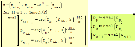

#4 Posted: 5/28/2021 6:40:26 PM
I understand the cause of the error
eval() is a general rule but an absolute rule.
Many projects fail from eval(,).
SS 6179 does not complain as you constructed.
eval(,) is applied afterwards to isolate/accelerate.

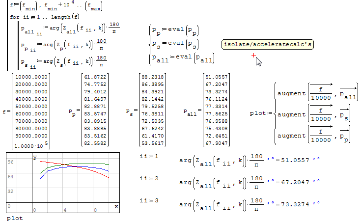

#5 Posted: 5/28/2021 8:33:21 PM
Good application case to globalize within the program.
... in my SS 6179 timing drops from 2.6 s down to 1.6 s

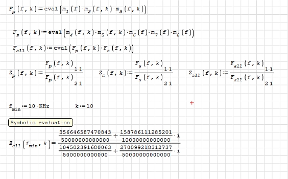

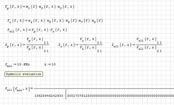

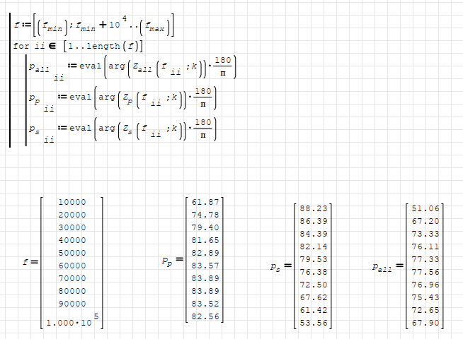

Hi Takez. Yes, it's very difficult recognize or even guess where the program needs some evals. Also, putting them everywhere make unreadable the procedures. In the case of your PPS.sm that's SMath stores into Z without eval
and this with it
So, for PPS.sm there is where you need to use eval, and seems that then all other calculations works.
