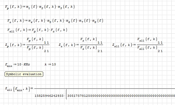

hi,
I'm a beginner
I get an error in the calculation
error :
result is above max. Allowed positive number
How can I solve it?

#2 Опубликовано: 28.05.2021 10:39:29
hi,
I'm a beginner
error :
How can I solve it?
Change your calculation result from symbolic to numeric.
You can do it with eval() since they are all numbers.

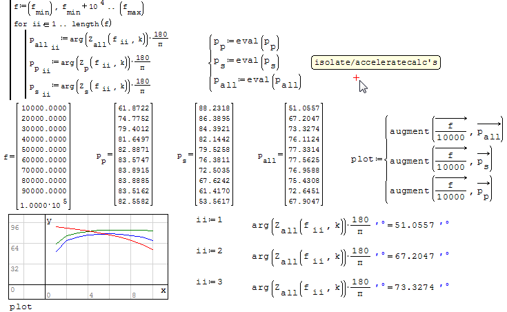

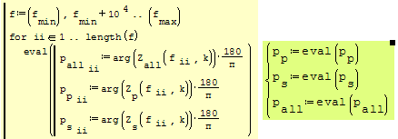

#4 Опубликовано: 28.05.2021 18:40:26
I understand the cause of the error
eval() is a general rule but an absolute rule.
Many projects fail from eval(,).
SS 6179 does not complain as you constructed.
eval(,) is applied afterwards to isolate/accelerate.

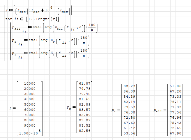

#5 Опубликовано: 28.05.2021 20:33:21
Good application case to globalize within the program.
... in my SS 6179 timing drops from 2.6 s down to 1.6 s

#6 Опубликовано: 28.05.2021 20:55:57
takeo kusumi
takeo kusumi
Thank you.
I was able to calculate the frequency characteristics
(PP2.sm)
But when I modify a circuit, I get an error even with eval.
(PPS.sm)
it's very difficult.
PPS.sm (176,46 КиБ) скачан 1135 раз(а).
PP2.sm (167,69 КиБ) скачан 1136 раз(а).

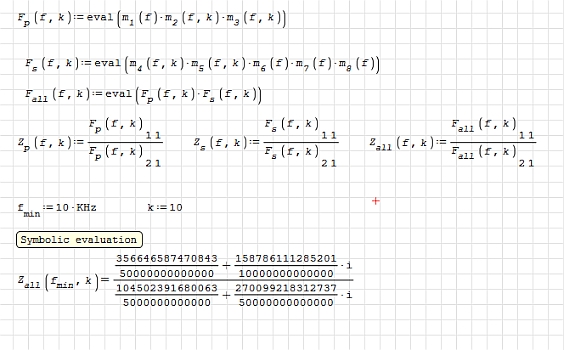

#8 Опубликовано: 29.05.2021 12:11:55
Thank you.
(PP2.sm)
(PPS.sm)
Hi Takez. Yes, it's very difficult recognize or even guess where the program needs some evals. Also, putting them everywhere make unreadable the procedures. In the case of your PPS.sm that's SMath stores into Z without eval
and this with it
So, for PPS.sm there is where you need to use eval, and seems that then all other calculations works.
#9 Опубликовано: 29.05.2021 12:33:20
Razonar's is the correct solution.
Deleting my post.
