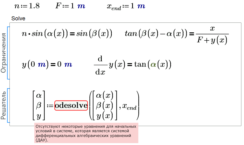

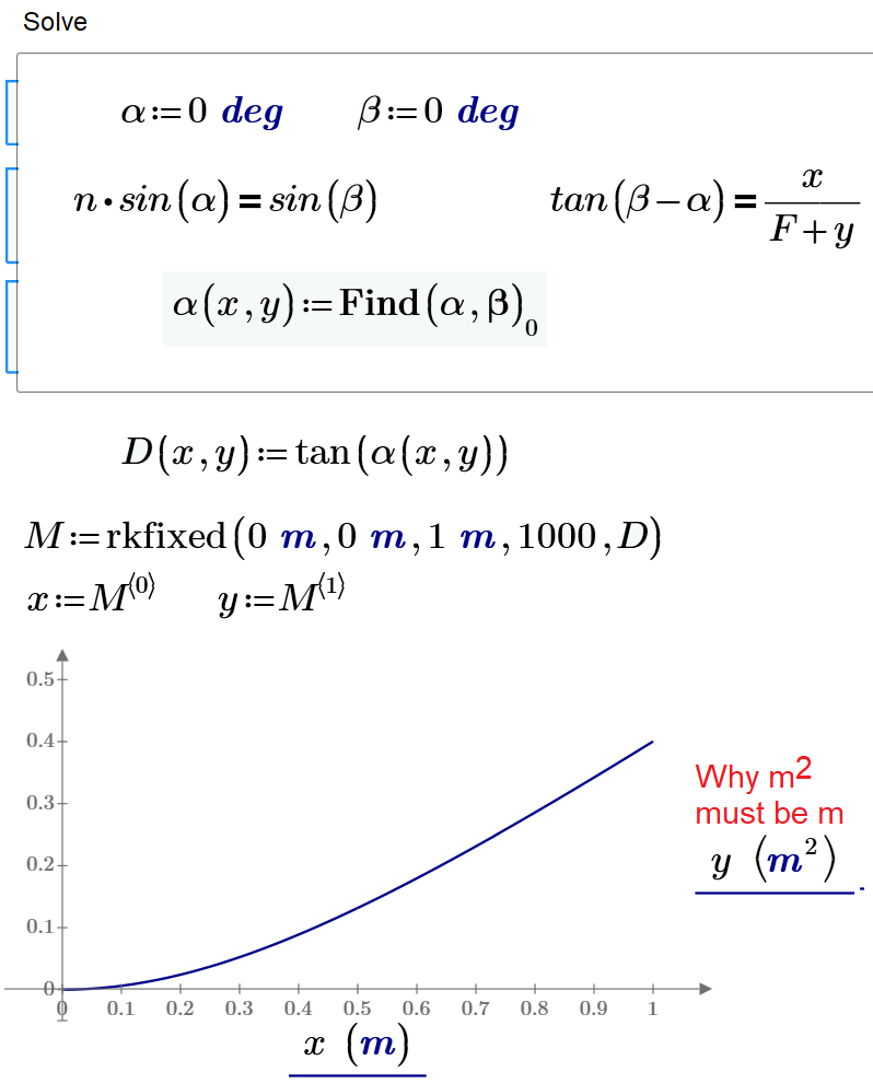

How can we use here a Mathcad-block?
Lens-Mathcad-Block.sm (43.8 KiB) downloaded 1756 time(s).
See too
https://en.smath.com/forum/yaf_postst25212_Lens.aspx
#2 Posted: 12/1/2024 6:08:12 PM
1,555 likes in 1,867 posts.
Here the function rkfixed() can't process the incoming expressions correctly. The block has nothing to do with it, it does not perform detailed analysis of expressions.
This is a bug in the function. The function has not been tested for this case. I can't see what's wrong here right now.
Valery Ochkov 12/2/2024 3:44:00 PM

Question - why is the answer meters squared, and not just meters?

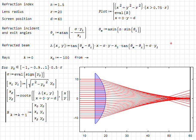

#10 Posted: 12/8/2024 8:58:47 AM
See too

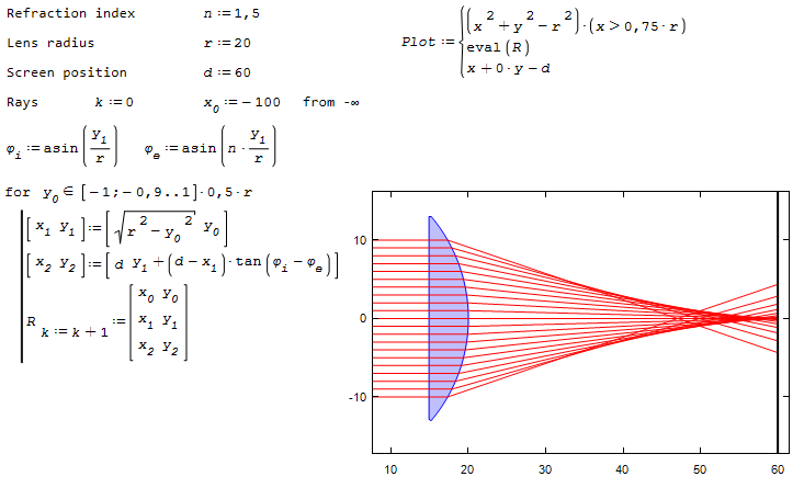

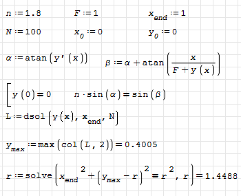

Hi. dsol can solve it with this setup:
RKA-Lens.sm (179.91 KiB) downloaded 1713 time(s).
I also use the Martin's setup for the plot.

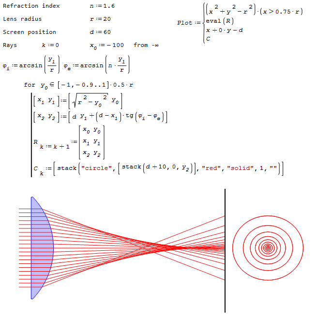

The last step

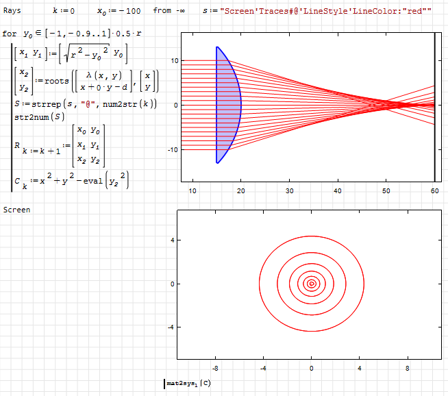

#14 Posted: 12/10/2024 9:21:41 PM
Hi. The screen. I also simplify a little the calculations.
spherical aberration.sm (26.41 KiB) downloaded 1844 time(s).
3 users liked this post
francesco rapuano 12/10/2024 11:05:00 PM, NDTM Amarasekera 12/10/2024 11:16:00 PM, Вячеслав Мезенцев 12/10/2024 11:19:00 PM
