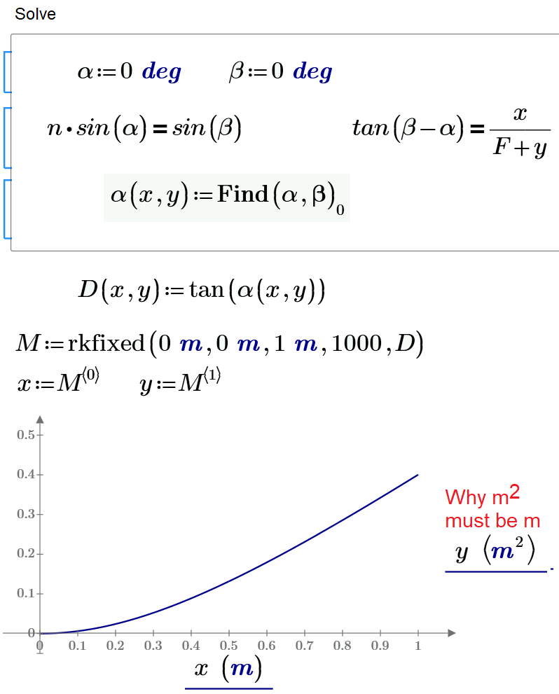

How can we use here a Mathcad-block?
Here the function rkfixed() can't process the incoming expressions correctly. The block has nothing to do with it, it does not perform detailed analysis of expressions.
This is a bug in the function. The function has not been tested for this case. I can't see what's wrong here right now.

This is not a solution of the rkfixed problem, just a little playing around with X-Y plot.
Here, an option of setting the aspect ratio of the axes to 1 would be good.

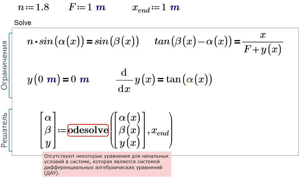

I am wondering if there is such a kind of Mathcad Prime odesolve for solving differential equations numerically also for SMath Studio somehow?

Question - why is the answer meters squared, and not just meters?

Because odesolve in Mathcad Prime:
1. Do not require to rewrite the differential equation of a higher order into a system of first order odes
2. Determines whether a system is stiff or nonstiff and then is using accordingly the stiff numerical differential eq solver or nonstiff numerical differential eq solver
3. Can solve numerically a system of differential equations (whatever it's a system of first order differential eq or a system of higher order differential eq)
What are these existing numerical solvers of differential eq in SMath? What are the posibilities of SMath to solve numerically differential equations? Exist at least one solver that mimic the Mathcad Prime odesolve (i.e. the 3 points above menționed)?

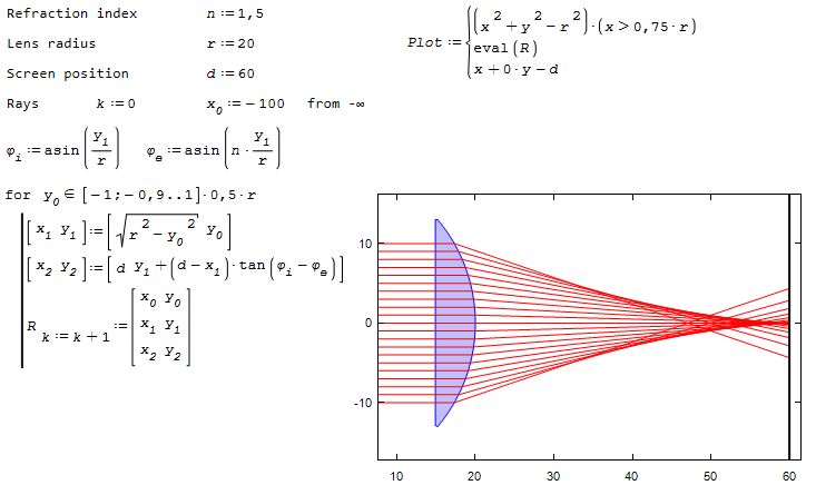

#10 Опубликовано: 08.12.2024 08:58:47
Lens-Mathcad-Block.sm (43,8 КиБ) скачан 1757 раз(а).
See too
https://en.smath.com/forum/yaf_postst25212_Lens.aspx

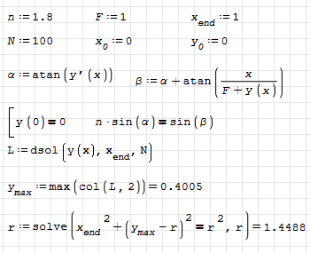

Hi. dsol can solve it with this setup:
RKA-Lens.sm (179,91 КиБ) скачан 1714 раз(а).
I also use the Martin's setup for the plot.

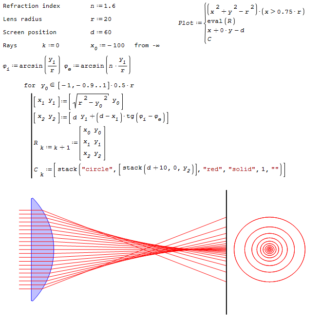

How to create this picture
https://en.wikipedia.org/wiki/Spherical_aberration
#12 Опубликовано: 10.12.2024 04:11:05

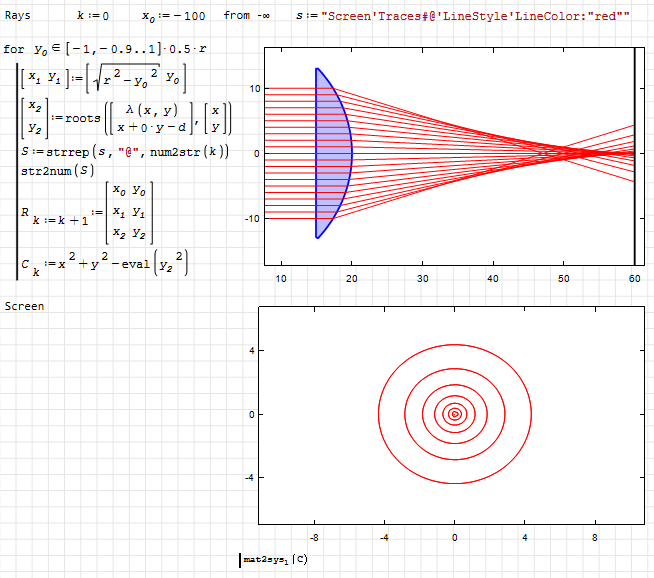

Hi Valery. This is a way.
spherical aberration.sm (15,88 КиБ) скачан 1704 раз(а).

#14 Опубликовано: 10.12.2024 21:21:41
Hi. The screen. I also simplify a little the calculations.
spherical aberration.sm (26,41 КиБ) скачан 1845 раз(а).

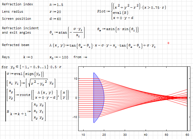

#16 Опубликовано: 11.12.2024 03:06:13
Root-free version of the spherical lens
spherical aberration_Kr.sm (12,37 КиБ) скачан 1646 раз(а).

#17 Опубликовано: 11.12.2024 06:22:06
Very elegant solution
Gracias Oscar! Pero espérate tantito nomás para que veas lo que puede hacer un doc alemán.
Thanks Oscar! But wait a little longer so you can see what a German doctor can do.
Oscar Campo 11.12.2024 12:09:00
