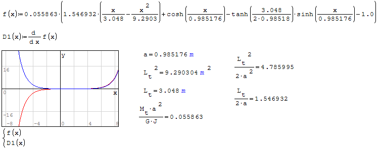

I am receiving an error which I did not receive in prior versions. The error is diff( , ) not defined.
Please excuse the crudeness of the attached calculation, it is an old version...
Any thoughts? Thanks!
Torsion - Test.sm (45 KiB) downloaded 75 time(s).

#4 Posted: 5/16/2016 8:51:43 PM
983 likes in 6866 posts.
To me, the problem relates to units.
