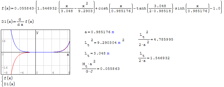

#4 Опубликовано: 16.05.2016 20:51:43
To me, the problem relates to units.
