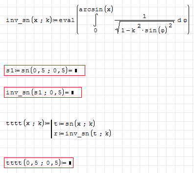

Please look at the attached worksheet.
function inv_sn(x,k) works fine in the main body, but fails is called from another function.
inv_sn.sm (4 KiB) downloaded 74 time(s).
#2 Posted: 10/6/2016 5:28:44 PM
CBG
CBG
77 likes in 312 posts.
You have to first define the function "sn".
To evaluate "tttt" uses the "=" not ": =".
Carlos
#3 Posted: 10/6/2016 7:24:27 PM
Mike Kaganski
Mike Kaganski
184 likes in 434 posts.
It should be noted that sn() seemingly depends on uni's EFI for Mathcad libraries; also, it's 32-bit only iirc. So, it OP wants others to see what he sees, he should mention the dependencies.
Here's what e.g. I see:
С уважением, Михаил Каганский

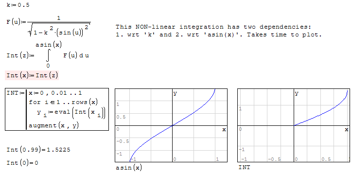

#4 Posted: 10/6/2016 11:15:53 PM
983 likes in 6866 posts.
... previously answered but let's see it.
