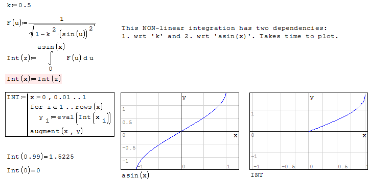

#4 Опубликовано: 06.10.2016 23:15:53
... previously answered but let's see it.
