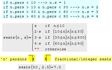

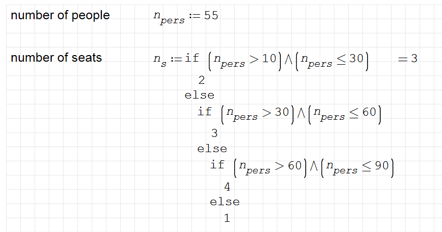

Hi I try to explain better what I want to calculate.
I would like to set up a for loop that allows me to do the same calculations as the if loop in the figure.
for example
if n.pers < 10 ---> n.s = 1
if n.pers > 10 & n.pers < 30 ---> n.s = 2
if n.pers > 30 & n.pers < 60 ---> n.s = 3
if n.pers > 60 & n.pers < 90 ---> n.s = 4
and so on
I don't know how if it's possible set up this cycle, anyway thanks.

You don't need an iteration.
Ceil() and cases() shall work for you.

#8 Posted: 10/12/2021 2:50:02 PM
127 likes in 342 posts.
The suggestion of Overlord is correct. You can also define a function and make different corresponding values ​​calculate (using the Vectorize function)
number_seat.sm (6.94 KiB) downloaded 1216 time(s).

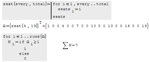

#12 Posted: 10/12/2021 8:25:44 PM
You can elongate at will:
1. collect the last condition from RHS
2. double coma
