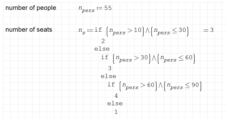

Hi I try to explain better what I want to calculate.
I would like to set up a for loop that allows me to do the same calculations as the if loop in the figure.

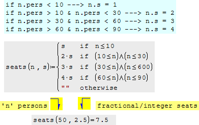

You don't need an iteration.
Ceil() and cases() shall work for you.

Hi
I'm probably doing something wrong because, for exemple, with 40 or 70 it doesn't work.

Probably, please use the file below.
seats.sm (2 КиБ) скачан 58 раз(а).

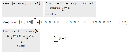

I don't know how if it's possible set up this cycle, anyway thanks.
You can elongate at will:
1. collect the last condition from RHS
2. double coma
