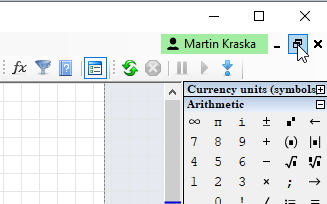

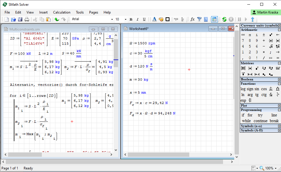

#4 Posted: 12/20/2022 6:30:24 AM
1226 likes in 2153 posts.
You actually can view multiple documents side by side (or in whatever arrangement) in a single instance.
Yet, there are no pre-defined arrangements, i.e. you have to resize the individual documents manually after you switch to multiple documents view.

#5 Posted: 12/20/2022 6:43:37 AM
NDTM Amarasekera
NDTM Amarasekera
130 likes in 352 posts.
I got it. Thank you very much.
