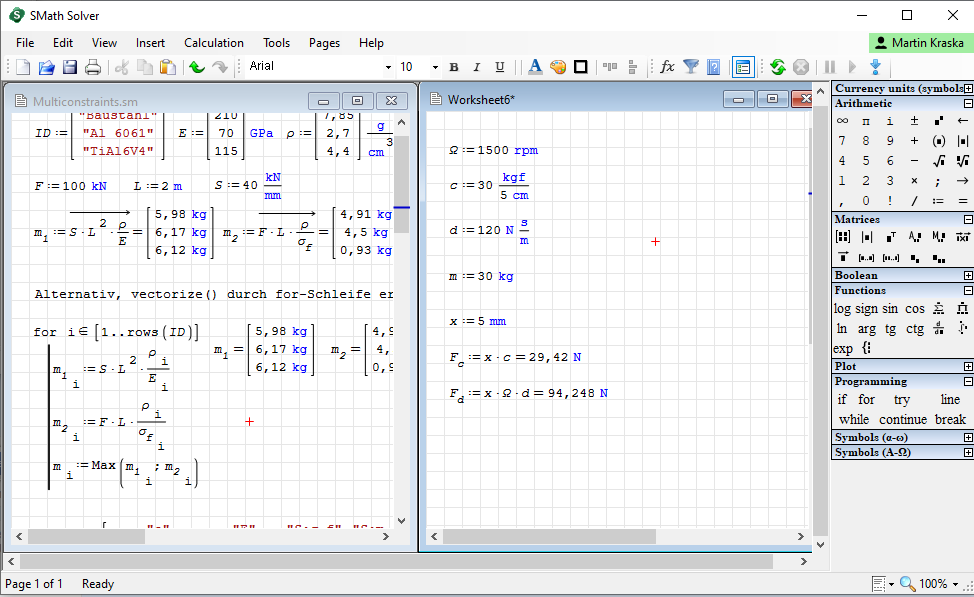

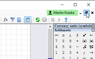

You actually can view multiple documents side by side (or in whatever arrangement) in a single instance.
Yet, there are no pre-defined arrangements, i.e. you have to resize the individual documents manually after you switch to multiple documents view.

I got it. Thank you very much.
