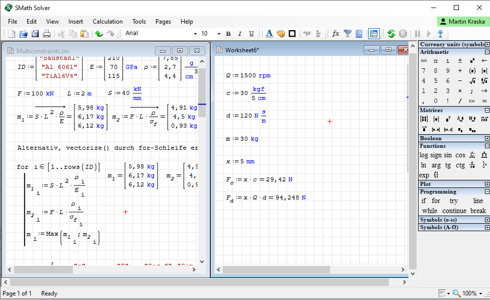

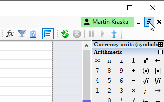

#4 Опубликовано: 20.12.2022 06:30:24
You actually can view multiple documents side by side (or in whatever arrangement) in a single instance.
Yet, there are no pre-defined arrangements, i.e. you have to resize the individual documents manually after you switch to multiple documents view.
I got it. Thank you very much.
