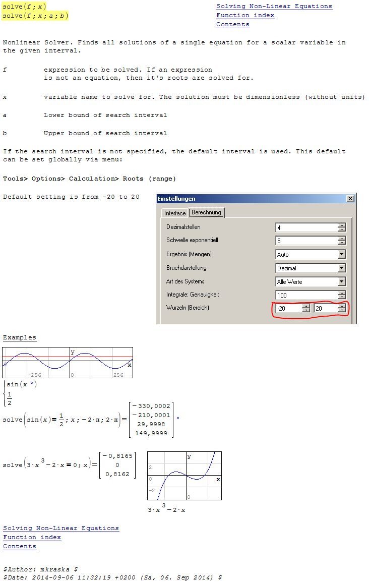

"solve(m/7-3;m)" не может решить, а "solve(m/6-3;m)" решает. Почему?
#2 Posted: 4/6/2018 10:24:06 AM
1226 likes in 2153 posts.
solve.sm (23 KiB) downloaded 72 time(s).

#3 Posted: 4/6/2018 11:47:50 AM
Вадим
Вадим
0 likes in 2 posts.
Thank you very much!
