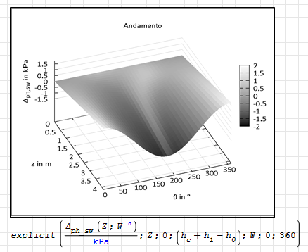

I've got a problem with a 3D plot function.
The function is very simple but i'm not able to find the correct syntax for plot it.
Someone can kindly help me with some advising?
Thancks in advance, i attacched below the Smath reference file where i had higlighted with an arrow the function.

For instructions on Maxima plots see https://doi.org/10.25933/opus4-2949
Note that the dummy variables need to be undefined in the sheet.

Thancks so much for your answer!!!!
I'm very gratefull!

WroteI've got a problem with a 3D plot function.
The document from Martin does not work for me.
At this point of the project, if you can attach the matrix,
I may try to render the gray image in RGB.
I have the RGB mapping codes associated with the vectorise code.
Not so sure ... your matrix is huge 360 cols !
