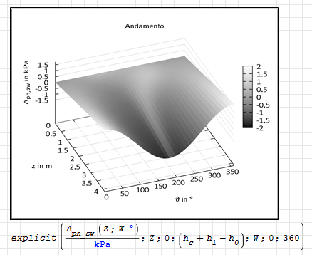

Hi
I've got a problem with a 3D plot function.
The function is very simple but i'm not able to find the correct syntax for plot it.
Someone can kindly help me with some advising?
Thancks in advance, i attacched below the Smath reference file where i had higlighted with an arrow the function.

#2 Posted: 11/29/2023 8:26:12 AM
For instructions on Maxima plots see https://doi.org/10.25933/opus4-2949
Note that the dummy variables need to be undefined in the sheet.

#4 Posted: 11/30/2023 1:19:16 AM
Very easy to get the two circles ... one being shifted.
Tip about X_Y plot ... as soon as you open, give a title.
Next manipulation, click on title.
That technique will save from freaking X,Y ranges.
Jean.
Jean.
