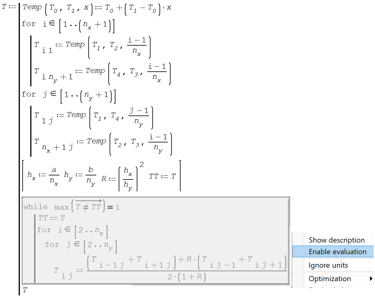

Disable Evaluation
Disable Evaluation - In a part of program - Messages

We have it algo style...
Lot more powerful/simpler, composed @ will.
Cheers ... Jean.
Maths algo ADVANCED.sm (15 KiB) downloaded 76 time(s).

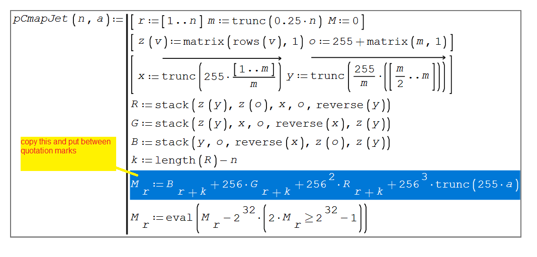

Putting that block between quotation marks ("..." ) is a tricky option. That converts that block into a text or a "commentary" to your code. When you need that block to be evaluated, copy the text between the quotation marks and paste it into the code.
Example:
Now the block is a "commentary":
Revert the process to enable evaluation
Best,
