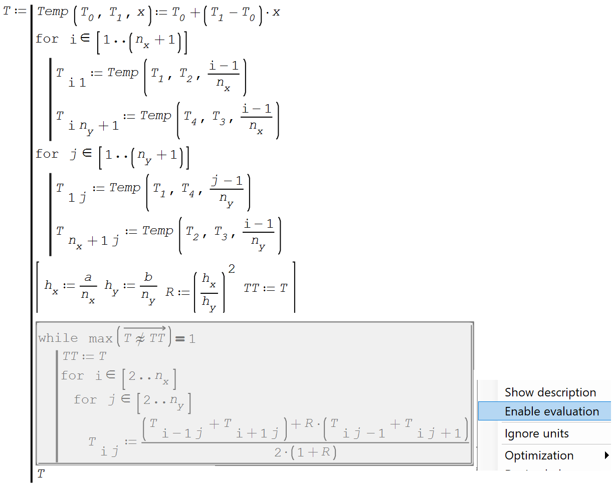

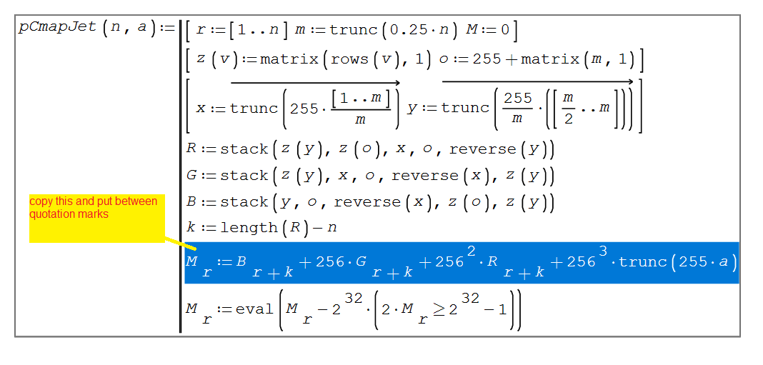

Putting that block between quotation marks ("..." ) is a tricky option. That converts that block into a text or a "commentary" to your code. When you need that block to be evaluated, copy the text between the quotation marks and paste it into the code.
Example:
Now the block is a "commentary":
Revert the process to enable evaluation
Best,
Oscar
