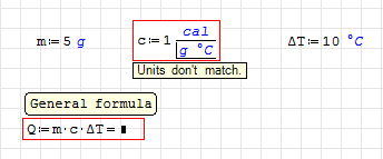

#1 Posted: 3/4/2017 5:19:39 PM

You must not use °C as a unit of temperature differences. Use Δ°C or K in these cases.
