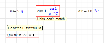

Units do not Match - Why?

You must not use °C as a unit of temperature differences. Use Δ°C or K in these cases.
