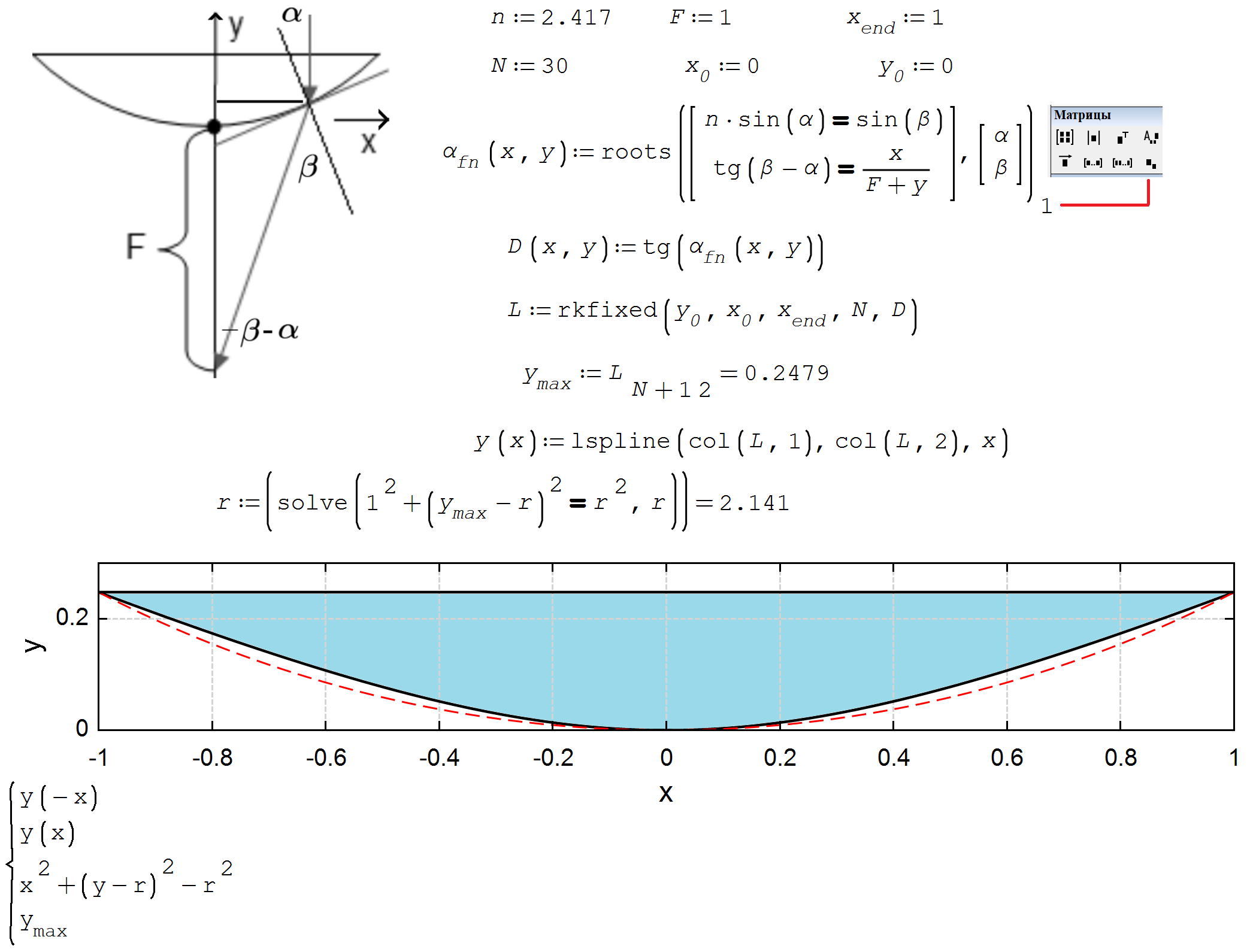

#1 Posted: 4/27/2024 2:15:52 PM
Valery Ochkov
Valery Ochkov
66 likes in 697 posts.
Lens.sm (362.46 KiB) downloaded 1551 time(s).

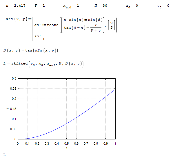

#2 Posted: 4/27/2024 8:49:01 PM
StvMath
StvMath
44 likes and 1 dislikes in 71 posts.
Looks like the algebraic relationships need to be separated out:
Lens_stv.sm (363.89 KiB) downloaded 1608 time(s).

Can we use here the Mathcad-block for ODE solution?
See please the attach
Lens.sm (118 KiB) downloaded 1516 time(s).
#4 Posted: 5/1/2024 2:07:58 PM
Valery Ochkov
Valery Ochkov
The solution at N>30 and with units
Lens-Euler-RungeKutta.sm (59.18 KiB) downloaded 1580 time(s).
