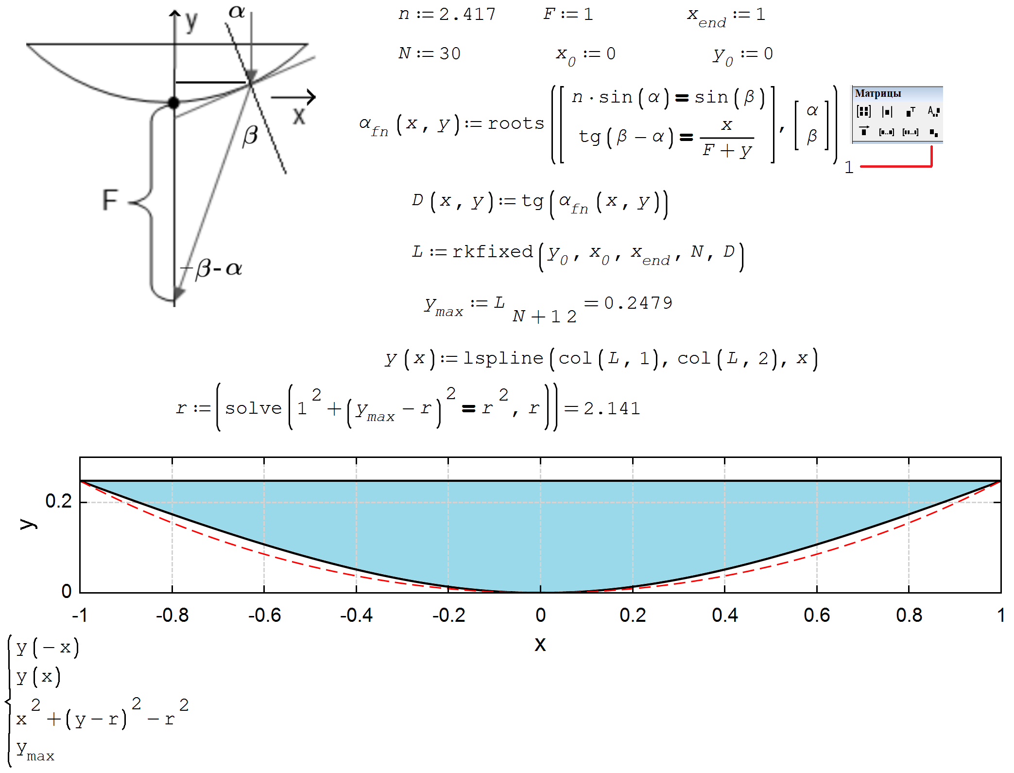

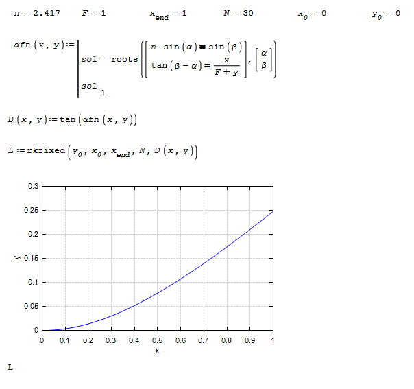

New question.
Can we use here the Mathcad-block for ODE solution?
See please the attach
Lens.sm (118 КиБ) скачан 1514 раз(а).
#4 Опубликовано: 01.05.2024 14:07:58
Valery Ochkov
Valery Ochkov
The solution at N>30 and with units
Lens-Euler-RungeKutta.sm (59,18 КиБ) скачан 1578 раз(а).
