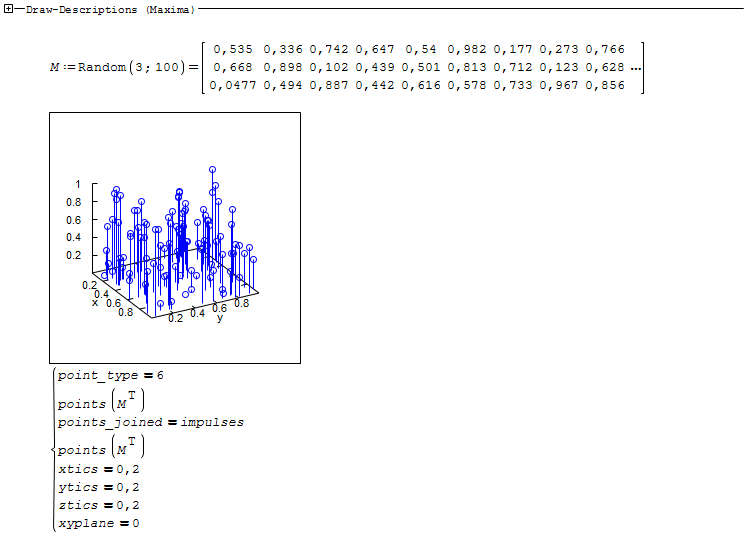

Hello everyone, I have been working since some time in SMath Studio and I encountered a problem with the function approximation show on 3D chart.
I have variable M and I can show the points on graph but I want make something like in the picture 2.
There is my question... Can SMath Studio handle with this?
I would like to do it on standard 3D chart not on "3D Plot" plugin, because this plugin doesn't work on my computer.
picture 1
picture 2
#2 Posted: 1/7/2019 7:05:22 PM
If you can install Maxima and the Maximaplugin on your computer, then you can use Maxima graphics functions.
3di.sm (137.54 KiB) downloaded 1331 time(s).

It works!
Thank you so much for very fast answer.
