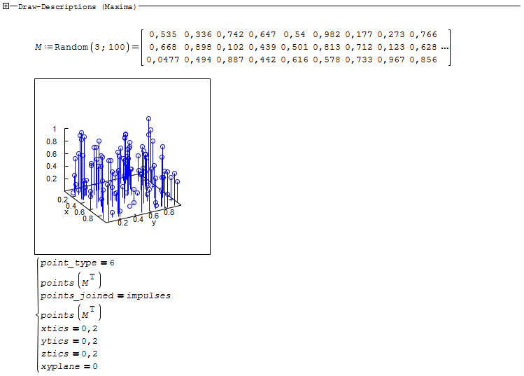

Hello everyone, I have been working since some time in SMath Studio and I encountered a problem with the function approximation show on 3D chart.
I have variable M and I can show the points on graph but I want make something like in the picture 2.
There is my question... Can SMath Studio handle with this?
I would like to do it on standard 3D chart not on "3D Plot" plugin, because this plugin doesn't work on my computer.
picture 1
picture 2
#2 Опубликовано: 07.01.2019 19:05:22
If you can install Maxima and the Maximaplugin on your computer, then you can use Maxima graphics functions.
3di.sm (137,54 КиБ) скачан 1331 раз(а).

#3 Опубликовано: 07.01.2019 21:21:03
deretvir
deretvir
It works!
Thank you so much for very fast answer.
Kind regards
