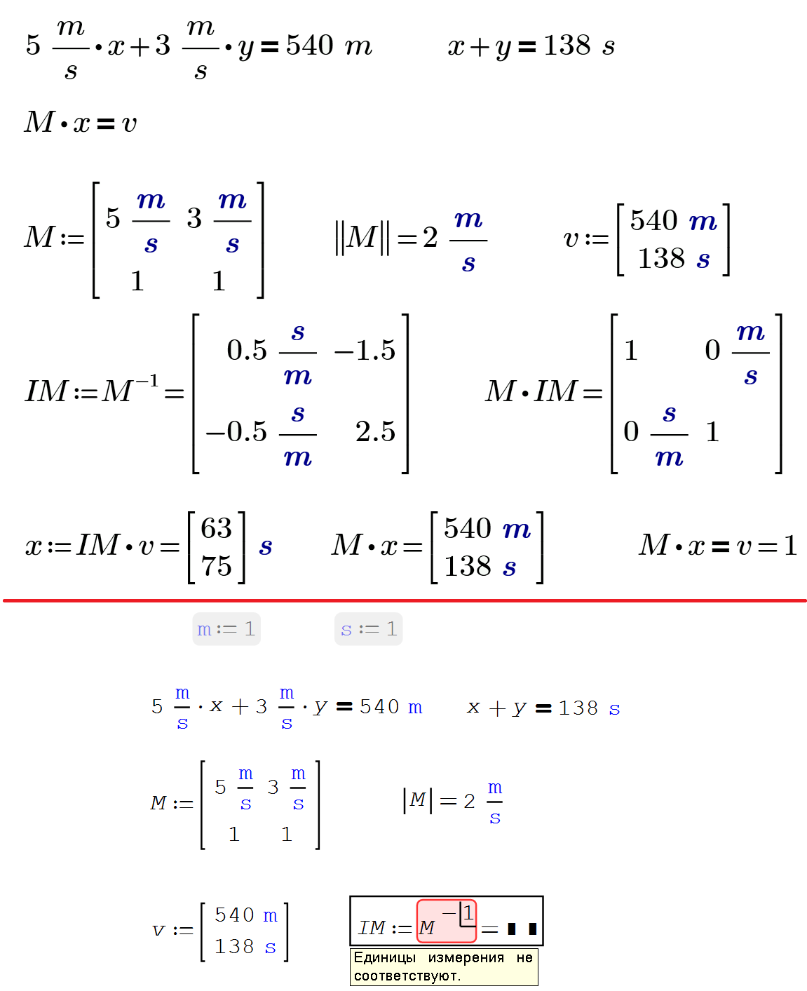

#1 Posted: 5/21/2024 11:45:13 AM
Valery Ochkov
Valery Ochkov
66 likes in 697 posts.
Mathcad vs SMath

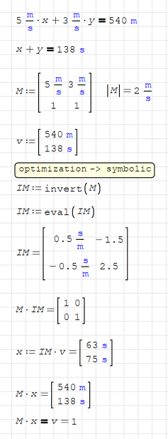

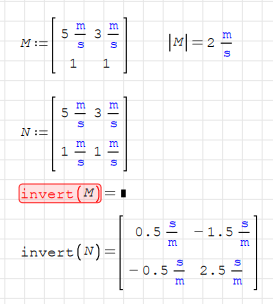

There is invert() function for that but it won't work with mixed units.
#3 Posted: 5/21/2024 5:10:58 PM
598 likes in 1,380 posts.
Nevermind, I found a way for invert.
Here is your solution.
invert.sm (9.09 KiB) downloaded 1679 time(s).

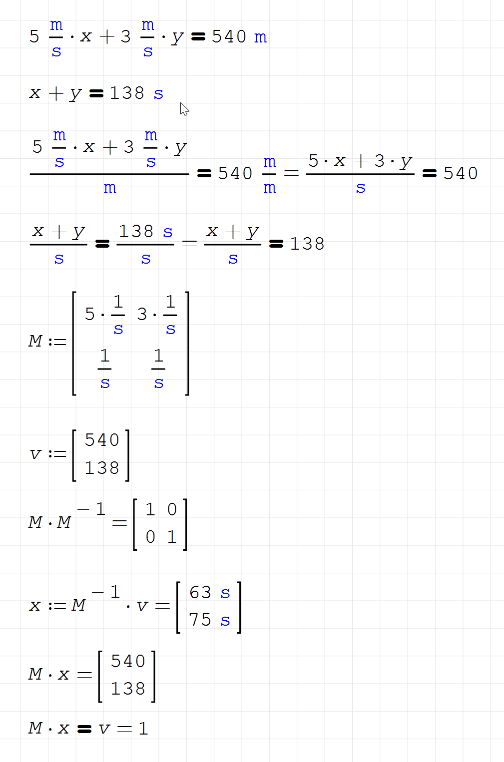

#4 Posted: 5/21/2024 6:19:03 PM
127 likes in 342 posts.
I take inspiration from Overlord
