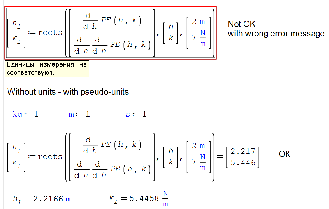

Can Roots and Solve functions work with units?
See please the attach!2-4-OOO-Plots-DD.sm (14.94 KiB) downloaded 1351 time(s).
There are several ways to handle units with SMath roots. This is one of them, where the units are sterilized (Pompelmo' dixit) locally, instead of globally.
2-4-OOO-Plots-DD.sm (12.96 KiB) downloaded 1315 time(s).

Thank you, but this is very difficult for me.
The question was simple: Roots & Units.
#7 Posted: 5/19/2023 8:08:52 PM
It is simple, if you use Findroot()
2-4-OOO-Plots-DD_Kr.sm (16.37 KiB) downloaded 1322 time(s).

Why?
#9 Posted: 5/20/2023 7:29:49 PM
Why ?... Not coded as per the plugin instruction code.

Why?
Use eval(), sometimes it resolves problems.
Especially it is useful on some solver situations.
