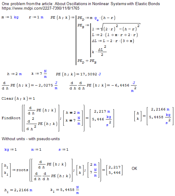

Can Roots and Solve functions work with units?
See please the attach!2-4-OOO-Plots-DD.sm (14,94 КиБ) скачан 1348 раз(а).

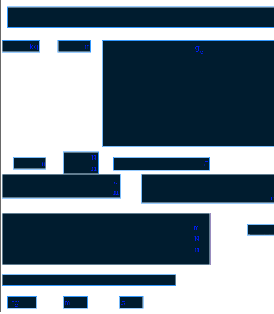

Sorry
#4 Опубликовано: 18.05.2023 11:35:10
Version freak ... So annoying !!!
Select all ... background icon white [bottom right]

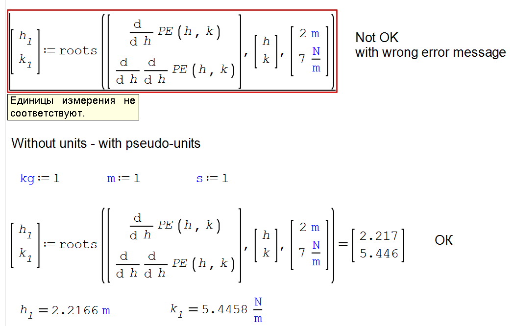

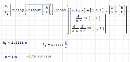

There are several ways to handle units with SMath roots. This is one of them, where the units are sterilized (Pompelmo' dixit) locally, instead of globally.
2-4-OOO-Plots-DD.sm (12,96 КиБ) скачан 1313 раз(а).

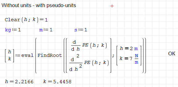

It is simple, if you use Findroot()
2-4-OOO-Plots-DD_Kr.sm (16,37 КиБ) скачан 1320 раз(а).

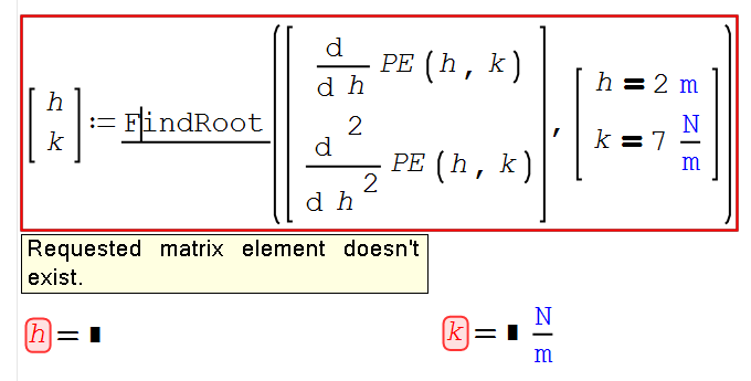

Valery Ochkov 20.05.2023 02:27:00
#8 Опубликовано: 20.05.2023 02:28:48
Valery Ochkov
Valery Ochkov

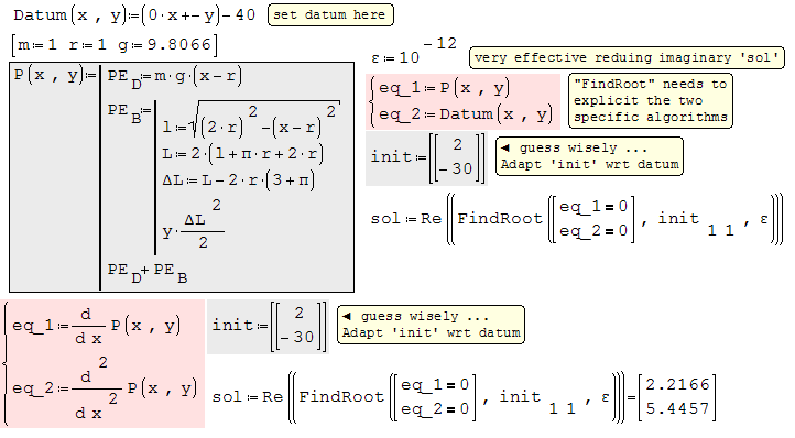

Why?
#9 Опубликовано: 20.05.2023 19:29:49
Why ?... Not coded as per the plugin instruction code.
Valery Ochkov 21.05.2023 02:14:00
#10 Опубликовано: 20.05.2023 20:02:35
Why?
Use eval(), sometimes it resolves problems.
Especially it is useful on some solver situations.
