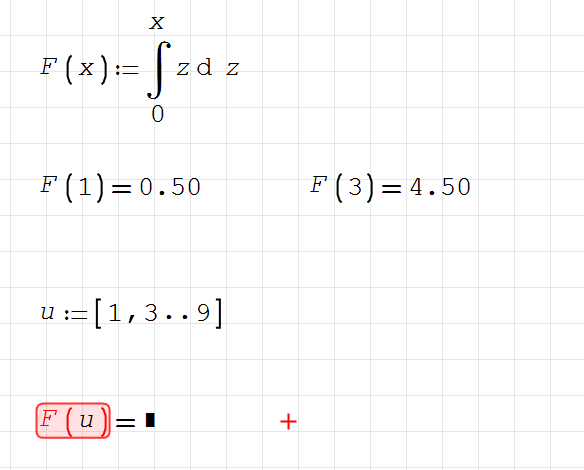

#1 Posted: 1/30/2021 11:19:03 AM
netsonicyxf
netsonicyxf
2 likes in 79 posts.
Smath
MathCAD Prime

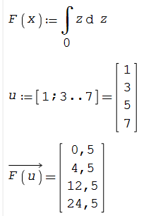

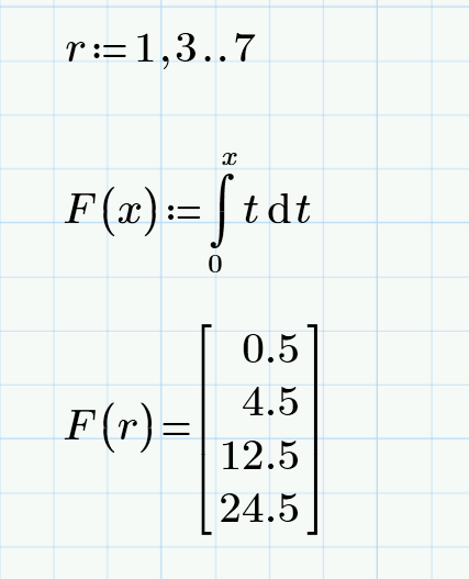

#2 Posted: 1/30/2021 11:41:19 AM
127 likes in 342 posts.
in Smath you have to use explicit vectorization

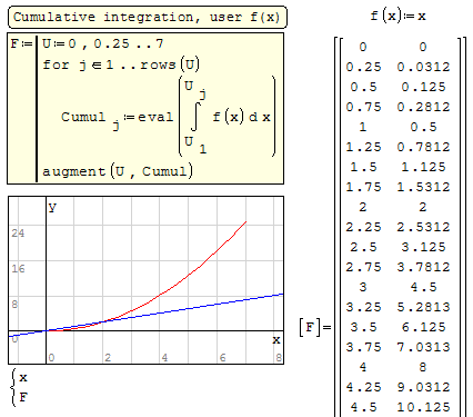

#5 Posted: 1/30/2021 11:09:00 PM
... hyperfast.

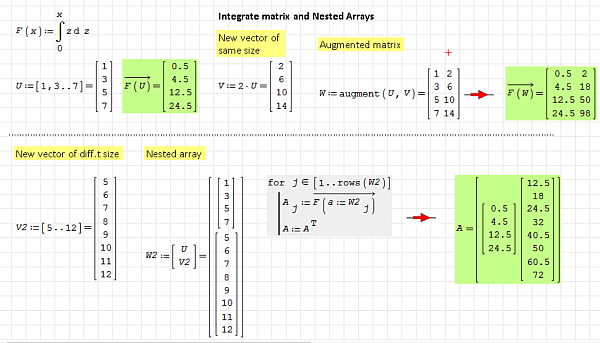

#6 Posted: 1/31/2021 3:09:04 AM
NDTM Amarasekera
NDTM Amarasekera
130 likes in 352 posts.
Integration values extended to matrix and nested arrays.

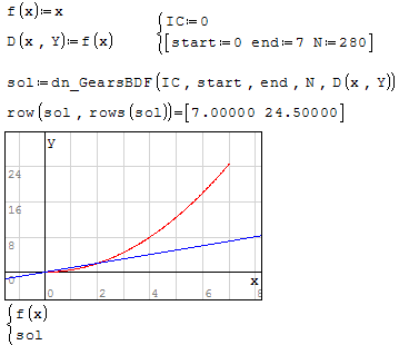

#7 Posted: 1/31/2021 12:02:40 PM
@ netsonicyxf
In the mean time you cogitate more integration visit Samples
Simpson ranges from exact [I only know two functions] to absolute crap.
In cases considered adequate, it may still be a poor integrator.
... poor integrator on the long range of the integration variate X.
This case is rescued via Romberg-Simpson ... in the attachment.
Other integrations are only possible via Carlos Adaptive ∫Adaptive(f,a,b,N,ε).
These two documents are minimalist visit.
Good idea to first construct the project unit-less.
Chhers ... Jean
Integrate Compendium_20 Simpson-Romberg Adaptive.sm (139.06 KiB) downloaded 1204 time(s).
Integral 00000000 MASTER ToolBox.sm (477.13 KiB) downloaded 1135 time(s).
