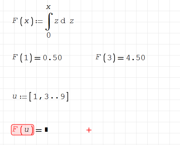

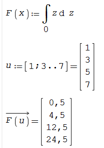

#2 Опубликовано: 30.01.2021 11:41:19
in Smath you have to use explicit vectorization

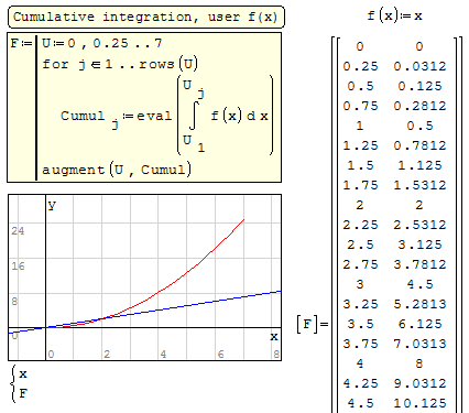

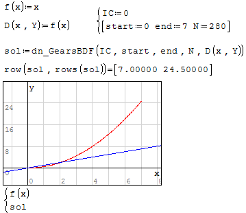

#5 Опубликовано: 30.01.2021 23:09:00
... hyperfast.

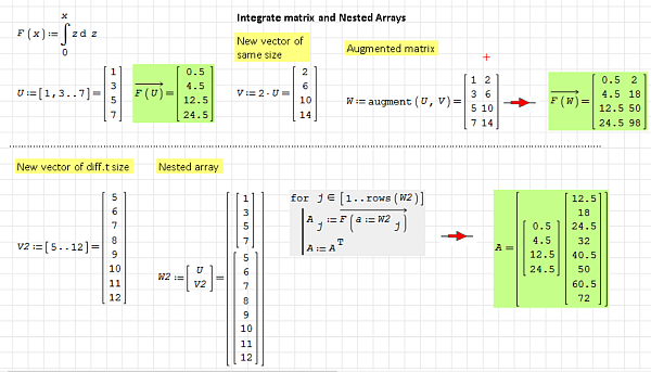

Integration values extended to matrix and nested arrays.
