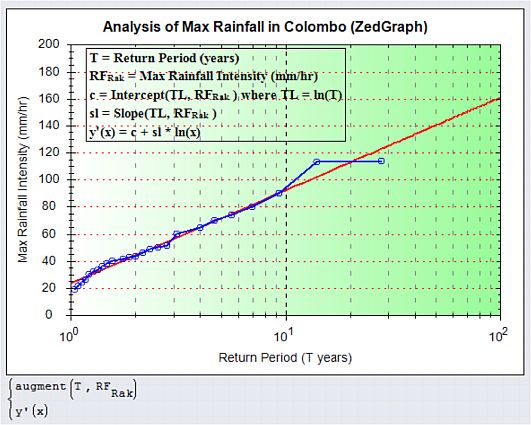

#2 Posted: 1/18/2017 4:20:37 AM
NDTM Amarasekera
NDTM Amarasekera
130 likes in 352 posts.
I also tried semi-log using X-Y Plot, but could not find a way.
However, it is possible using ZedGraph plugin.
Davide Carpi 1/18/2017 10:33:00 AM, frapuano 2/18/2018 8:47:00 AM

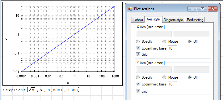

#3 Posted: 1/18/2017 1:05:03 PM
loglog and semilog plots can be created with Maxima Draw.
Insert> Maxima> Maxima Draw2D
Then you can specify graphics objects. There is partial support for the settings in the context menu. These settings also can be specified in the graphics command list.
An example with log plot can be found here
loglog.sm (17.73 KiB) downloaded 1448 time(s).
4 users liked this post
sergio 1/18/2017 3:34:00 PM, Radovan Omorjan 1/18/2017 3:36:00 PM, Davide Carpi 1/18/2017 7:51:00 PM, frapuano 2/18/2018 8:46:00 AM
