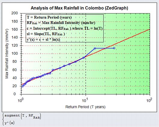

I also tried semi-log using X-Y Plot, but could not find a way.
However, it is possible using ZedGraph plugin.

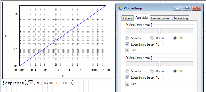

loglog and semilog plots can be created with Maxima Draw.
Insert> Maxima> Maxima Draw2D
Then you can specify graphics objects. There is partial support for the settings in the context menu. These settings also can be specified in the graphics command list.
An example with log plot can be found here
loglog.sm (17 КиБ) скачан 309 раз(а).
