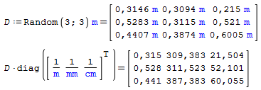

#4 Posted: 1/31/2020 9:30:23 AM
Assuming you have a table with columnwise uniform units, then the following approach provides full control:
exportdata.sm (4.81 KiB) downloaded 1145 time(s).
