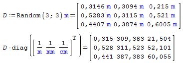

#4 Опубликовано: 31.01.2020 09:30:23
Assuming you have a table with columnwise uniform units, then the following approach provides full control:
exportdata.sm (4 КиБ) скачан 69 раз(а).
Pre-configured portable distribution of SMath Studio: https://en.smath.info/wiki/SMath%20with%20Plugins.ashx
