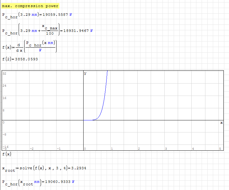

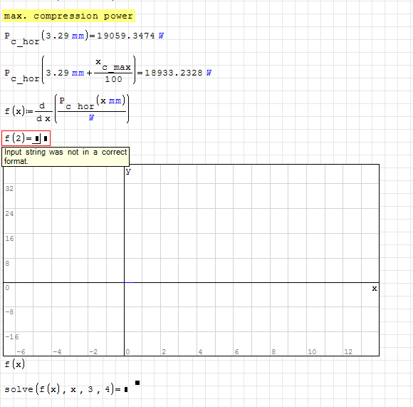

Dear all,
I am currently struggling with a basic function extreme problem
NOK.sm (15 KiB) downloaded 1170 time(s).
OK.sm (60.92 KiB) downloaded 1126 time(s).
edit by mod: names of attachments are swapped, as mentioned below
In the first screenshot, the function derivative definition results in a warning message: "input string was not in a correct format"
In the last screenshot, I removed all parameters values that aren't related to the given formulas (not visible in the screenshot), and I get the right solution?! However, I don't see the root visually in the accompanying graph?
I thought it had something to do with the reservation of parameter "x", but this doesn't seem to be the case...
Thanks in advance for any feedback!
Kind regards from Belgium,
Jan
The root(s) won't appear by magic ! You must instruct the plot.
Click left/right on the 2nd plot ... enable "Display input data"

What I meant was that the derivative graph doesn't cross the X-axis at x=3.29, this is where the original function P_c_hor(x) reaches it's maximum.
This is odd, since the root function indicates correctly a root at x=3.29 in the file NOK.sm (I switched the names the smath files, my mistake... ).
So my question remains: why does the solve function doesn't work in both attached files?

#10 Posted: 8/16/2017 1:18:46 PM
... as it looks, the derivative as given is not accepted.
The mouse had problem digesting the elephant .
Done from infinitesimal analysis ... OK.
Maybe I open the wrong sheet ?
OK repaired.sm (63.49 KiB) downloaded 1148 time(s).

#12 Posted: 8/17/2017 2:46:41 PM
However, it stays unclear why my approach works in sheet "nok.sm" and not in "ok.sm", while it's 100% the same in both cases?!
There seems to be something wrong underneath the smath "boot"?
Can't explain either. NO unit plots much smaller in magnitude and the function q(x) ends @ 3.5.
Infinitesimal analysis is a Lagrangian method that existed before "Symbolic engines".
Was effective for Excel to manage more advanced maths before Mathcad/Mathsoft... Maple.
It applies to 2nd derivative as well and integral. The 2nd derivative
starts producing noise [world is not perfect]. The Lagrangian methods extend
to point derivatives/integral ... very useful for point capture systems like
in Process Control & Instrumentation where have only values [accumulated values].
In the red, in the attached, I have isolated the Guilty ... Ah !
As it looks, with the unit system those "Guilty" may be smaller, thus less guilty.
Cheers, Jean
OK repaired.sm (144.28 KiB) downloaded 1174 time(s).

#18 Posted: 8/23/2017 10:05:56 AM
Jan Claeys
Jan Claeys
2 likes in 25 posts.
Hello Davide,
I run the latest beta (build 6437), and f(2) on the last page of "ok.sm" doesn't result in an answer (the standard smath derivative function doesn't work)? I run Windows 7 Pro.
"nok.sm" does work, the reason for this is unclear because exactly the same formulas are used, however the graph doesn't show the correct shape of the derivative function.
It would be very strange if your configuration would be errorless?
There has to be a program mistake somewhere?
Kind regards,
Jan

#20 Posted: 8/23/2017 11:57:54 AM
It is strange indeed. Can you confirm that the error display on the uploaded file for you (download > open > error is shown; I mean, there were no issues while choosing the file to upload)
I run the same version as your, on Win7 home. It might be something related to some plugin (to check it you can rename your %APPDATA%\smath folder into something different, then you can load a new instance of SS studio and check if something is changed) or might be something else, I'll try to see if I can found a way to replicate it at least find the cause for that error message.
