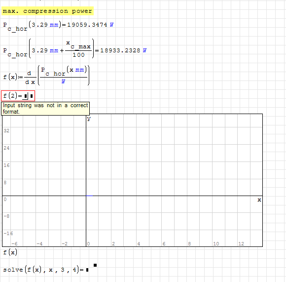

Dear all,
I am currently struggling with a basic function extreme problem
NOK.sm (15 КиБ) скачан 1169 раз(а).
OK.sm (60,92 КиБ) скачан 1125 раз(а).
edit by mod: names of attachments are swapped, as mentioned below
In the first screenshot, the function derivative definition results in a warning message: "input string was not in a correct format"

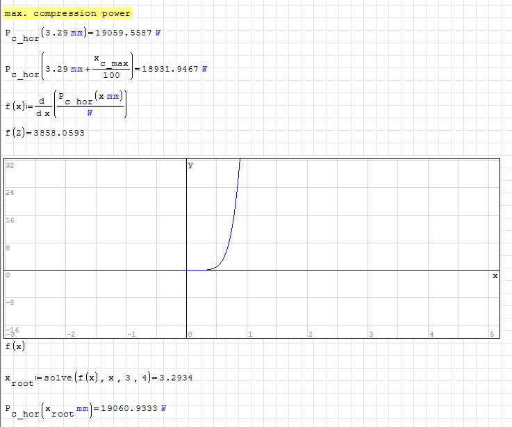

In the last screenshot, I removed all parameters values that aren't related to the given formulas (not visible in the screenshot), and I get the right solution?! However, I don't see the root visually in the accompanying graph?
I thought it had something to do with the reservation of parameter "x", but this doesn't seem to be the case...

What I meant was that the derivative graph doesn't cross the X-axis at x=3.29, this is where the original function P_c_hor(x) reaches it's maximum.
This is odd, since the root function indicates correctly a root at x=3.29 in the file NOK.sm (I switched the names the smath files, my mistake... ).
So my question remains: why does the solve function doesn't work in both attached files?

As far as I can see, the problem seems to be (amongst others?) the use of units, since you removed every unit?
I am aware that good old Mathcad (when it still belonged to Mathsoft, PTC made a mess of it...) also struggled with this.
However, it stays unclear why my approach works in sheet "nok.sm" and not in "ok.sm", while it's 100% the same in both cases?!
There seems to be something wrong underneath the smath "boot"?
I will study the sheet more in detail (and put every value into SI) tomorrow at my work, thanks again!
Can't explain either. NO unit plots much smaller in magnitude and the function q(x) ends @ 3.5.
Infinitesimal analysis is a Lagrangian method that existed before "Symbolic engines".
Was effective for Excel to manage more advanced maths before Mathcad/Mathsoft... Maple.
It applies to 2nd derivative as well and integral. The 2nd derivative
starts producing noise [world is not perfect]. The Lagrangian methods extend
to point derivatives/integral ... very useful for point capture systems like
in Process Control & Instrumentation where have only values [accumulated values].
In the red, in the attached, I have isolated the Guilty ... Ah !
As it looks, with the unit system those "Guilty" may be smaller, thus less guilty.
Cheers, Jean

I made a revised version of my original document today, based on your remarks. Luckily, I managed to keep the units "on board": by doing so the document is more readable for my colleagues.
Every value is correctly evaluated now: yes!
Thank you for the hint about the infinitesimal derivative, let's hope that SMath's next version will have a flawless standard derivative function, since the actual one doesn't seem to work...

I run the latest beta (build 6437), and f(2) on the last page of "ok.sm" doesn't result in an answer (the standard smath derivative function doesn't work)? I run Windows 7 Pro.
"nok.sm" does work, the reason for this is unclear because exactly the same formulas are used, however the graph doesn't show the correct shape of the derivative function.
It would be very strange if your configuration would be errorless?
There has to be a program mistake somewhere?

It is strange indeed. Can you confirm that the error display on the uploaded file for you (download > open > error is shown; I mean, there were no issues while choosing the file to upload)
I run the same version as your, on Win7 home. It might be something related to some plugin (to check it you can rename your %APPDATA%\smath folder into something different, then you can load a new instance of SS studio and check if something is changed) or might be something else, I'll try to see if I can found a way to replicate it at least find the cause for that error message.
