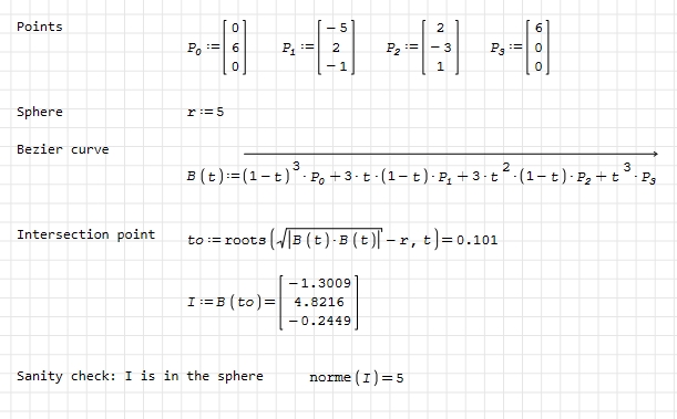

Hi. In the attached how to solve the problem numerically. Notice that B(t) must to be defined using vectorize, because SMath don't expand the scalar by vector products.
Sphere and Cubic.sm (8 KiB) downloaded 72 time(s).

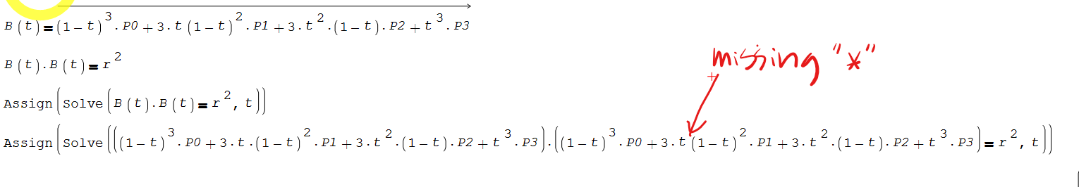

I really don't get what's wrong now...
Sphere and cubic Bezier curve intersection points.sm (12 KiB) downloaded 79 time(s).
#14 Posted: 9/16/2021 9:40:26 AM
Oscar Campo
Oscar Campo
124 likes in 298 posts.
There is a missing "*"
