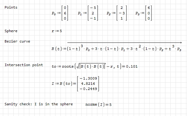

Hi. In the attached how to solve the problem numerically. Notice that B(t) must to be defined using vectorize, because SMath don't expand the scalar by vector products.
Sphere and Cubic.sm (8,86 КиБ) скачан 1131 раз(а).

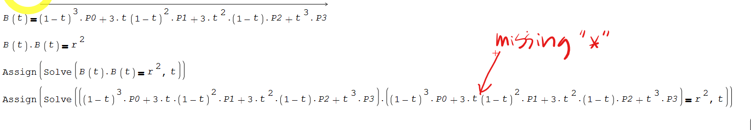

I really don't get what's wrong now...
Sphere and cubic Bezier curve intersection points.sm (12,04 КиБ) скачан 1211 раз(а).
There is a missing "*"
Thank you! But what should I do with «r is undefined»? 🤔

Are you sure you are using the option "Symbolic Optimization"?
You must right-click over your equation, then choose Optimization-Symbolic
#17 Опубликовано: 16.09.2021 11:40:06
Necronomicron
Necronomicron
Thank you very much! It worked! However, the roots are so long... Not sure I can use them... Thanks anyway! 😊
