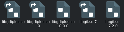

This happens because libgdiplus in appimage has missing symlinks.
I added and recompiled appimage with libgdiplus symlinks added.
Now it works. I don't know why Andrev didn't add those links, who knows?
Download appimage linked below, I have tried with linuxmint_22 live iso.
SMathStudioDesktop.1.2.9038-x86_64-linuxmint_22.glibc2.35.AppImage.tar.gz (11 MiB) downloaded 133 time(s).

I did extract content of original smath appimage from terminal via --appimage-extract argument.
Added libgif.so and symlinks for libgdiplus.
Mono library replacement shouldn't be necessary, only for just in case.
Andrey, you can take my appimage and extract its content.
Only smath file updates should be enough for new appimage creation.

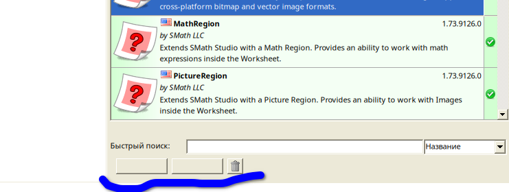

But some text can't be imaged like in the previous version

For the lacking of button texts, it is probably mono error.
Possibly I can't do anything about that.
