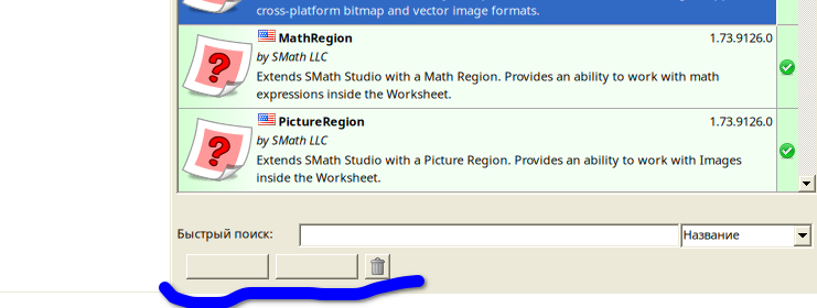

But some text can't be imaged like in the previous version

For the lacking of button texts, it is probably mono error.
Possibly I can't do anything about that.
