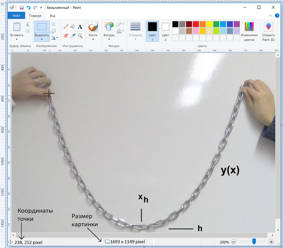

How to use here the al_nl plugin?
Catenary-Photo-an_nl.sm (1.2 MiB) downloaded 1592 time(s).

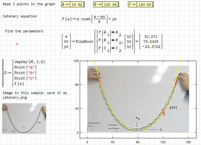

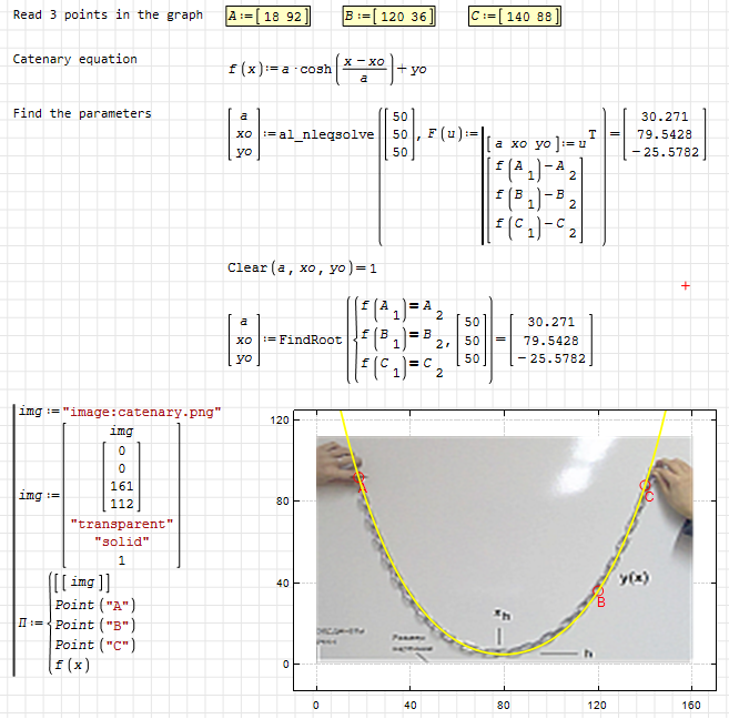

#5 Posted: 9/26/2024 4:36:41 AM
... the question was not about y(X), but al_nl****
Hi. Using the new functionality of XYPlot:
Image with size 161x112:
Smath file: img-catenary-al_nleqsolve.sm (19.15 KiB) downloaded 1435 time(s).
ioan92 9/27/2024 2:31:00 PM
