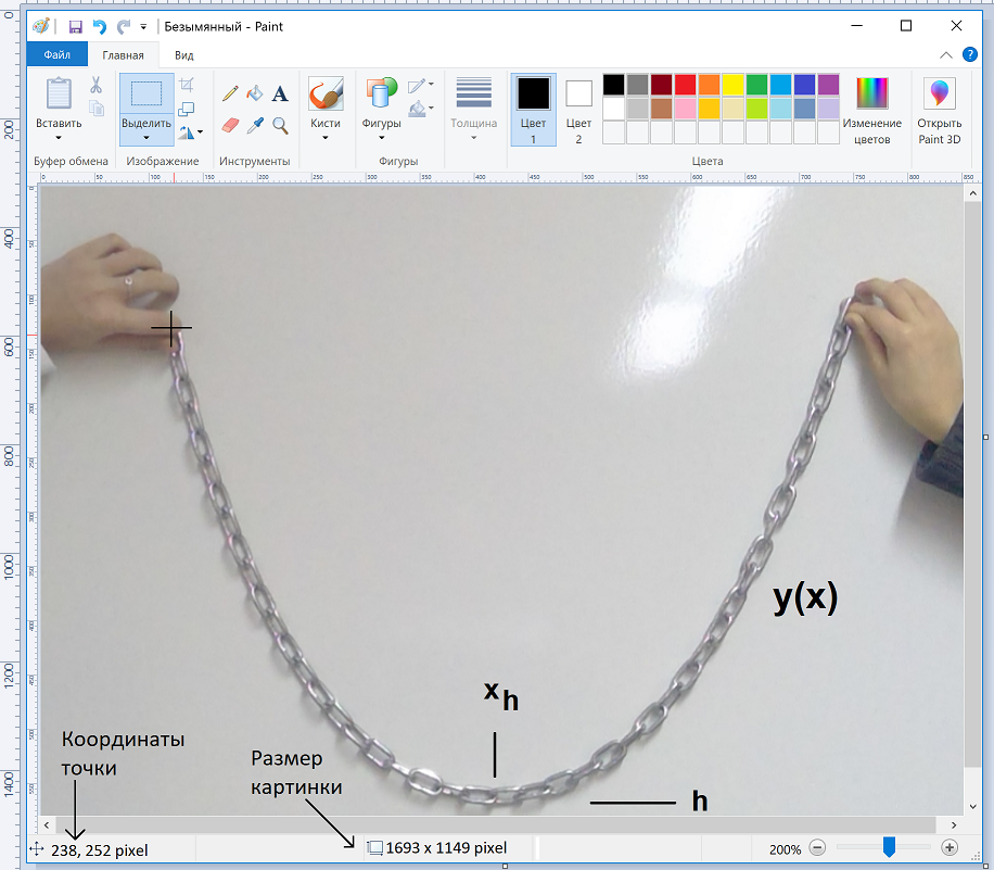

How to use here the al_nl plugin?
Catenary-Photo-an_nl.sm (1 МиБ) скачан 78 раз(а).

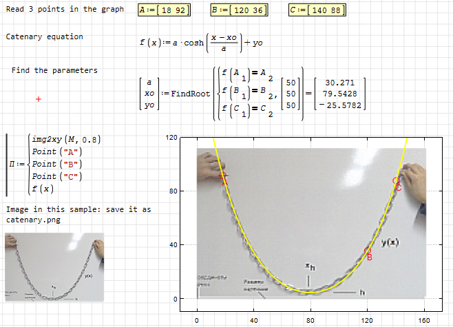

Hi Valery. You can try this.
img2xy-catenary.sm (2 МиБ) скачан 75 раз(а).

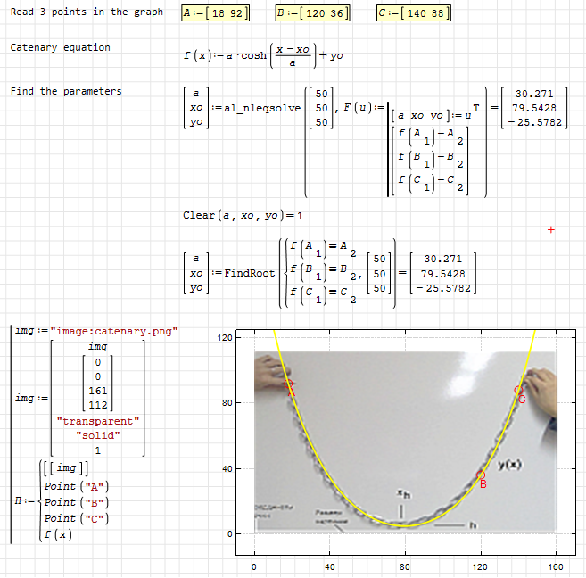

Hi. Using the new functionality of XYPlot:
Image with size 161x112:
Smath file: img-catenary-al_nleqsolve.sm (19 КиБ) скачан 67 раз(а).
