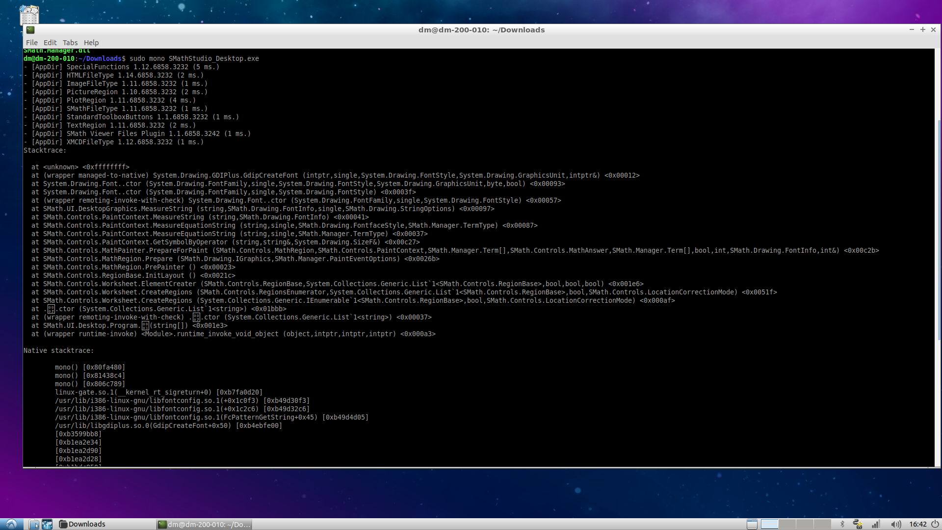

Hi, is anyone successfully using build 6839 on Linux? When I try to launch I get
[ERROR] FATAL UNHANDLED EXCEPTION: System.ArgumentException: The requested FontFamily could not be found [GDI+ status: FontFamilyNotFound]
followed by lines of what I assume are functions and memory locations where the error is thrown.
Build 6671 is still working for me, so using that in the meantime.
Any further information needed can be supplied, thanks in advance for any and all help with this.

The stack trace would be really useful
I can reproduce something similar in Linux Mint, it's the same issue?
mono SMathStudio_Desktop.exe
- [AppDir] SpecialFunctions 1.12.6839.38235 (9 ms.)
- [AppDir] HTMLFileType 1.14.6839.38235 (3 ms.)
- [AppDir] ImageFileType 1.11.6839.38235 (0 ms.)
- [AppDir] PictureRegion 1.10.6839.38235 (1 ms.)
- [AppDir] PlotRegion 1.11.6839.38235 (9 ms.)
- [AppDir] SMathFileType 1.11.6839.38235 (0 ms.)
- [AppDir] StandardToolboxButtons 1.1.6839.38235 (0 ms.)
- [AppDir] TextRegion 1.11.6839.38235 (0 ms.)
- [AppDir] SMath Viewer Files Plugin 1.1.6839.38249 (0 ms.)
- [AppDir] XMCDFileType 1.12.6839.38235 (1 ms.)
Stacktrace:
  at <unknown> <0xffffffff>
  at (wrapper managed-to-native) System.Drawing.GDIPlus.GdipCreateFont (intptr,single,System.Drawing.FontStyle,System.Drawing.GraphicsUnit,intptr& <0xffffffff>
  at System.Drawing.Font..ctor (System.Drawing.FontFamily,single,System.Drawing.FontStyle,System.Drawing.GraphicsUnit,byte,bool) <0x000af>
  at System.Drawing.Font..ctor (System.Drawing.FontFamily,single,System.Drawing.FontStyle) <0x00047>
  at (wrapper remoting-invoke-with-check) System.Drawing.Font..ctor (System.Drawing.FontFamily,single,System.Drawing.FontStyle) <0xffffffff>
  at SMath.UI.DesktopGraphics.MeasureString (string,SMath.Drawing.FontInfo,single,SMath.Drawing.StringOptions) <0x000cf>
  at SMath.Controls.PaintContext.MeasureString (string,SMath.Drawing.FontInfo) <0x0004f>
  at SMath.Controls.PaintContext.MeasureEquationString (string,single,SMath.Drawing.FontfaceStyle,SMath.Manager.TermType) <0x00097>
  at SMath.Controls.PaintContext.MeasureEquationString (string,single,SMath.Manager.TermType) <0x0003f>
  at SMath.Controls.PaintContext.GetSymbolByOperator (string,string&,System.Drawing.SizeF& <0x00f5f>
  at SMath.Controls.MathPainter.PrepareForPaint (SMath.Controls.MathRegion,SMath.Controls.PaintContext,SMath.Manager.Term[],SMath.Controls.MathAnswer,SMath.Manager.Term[],bool,int,SMath.Drawing.FontInfo,int& <0x00c9f>
  at SMath.Controls.MathRegion.Prepare (SMath.Drawing.IGraphics,SMath.Manager.PaintEventOptions) <0x002d7>
  at SMath.Controls.MathRegion.PrePainter () <0x00017>
  at SMath.Controls.RegionBase.InitLayout () <0x002a9>
  at SMath.Controls.Worksheet.ElementCreater (SMath.Controls.RegionBase,bool,bool,bool) <0x0027d>
  at SMath.Controls.Worksheet.CreateRegions (System.Collections.Generic.IEnumerable`1<SMath.Controls.RegionBase>,bool,SMath.Controls.LocationCorrectionMode) <0x0064f>
  at ...ctor (System.Collections.Generic.List`1<string> <0x01e4b>
  at (wrapper remoting-invoke-with-check) ...ctor (System.Collections.Generic.List`1<string> <0xffffffff>
  at SMath.UI.Desktop.Program. (string[]) <0x0024b>
  at (wrapper runtime-invoke) <Module>.runtime_invoke_void_object (object,intptr,intptr,intptr) <0xffffffff>
Native stacktrace:
	mono() [0x4b73d8]
	mono() [0x50f13b]
	mono() [0x423d22]
	/lib/x86_64-linux-gnu/libpthread.so.0(+0x10330) [0x7fa34a779330]
	/usr/lib/x86_64-linux-gnu/libfontconfig.so.1(+0x1b2ed) [0x7fa34552f2ed]
	/usr/lib/x86_64-linux-gnu/libfontconfig.so.1(+0x1ba29) [0x7fa34552fa29]
	/usr/lib/x86_64-linux-gnu/libfontconfig.so.1(+0x1c798) [0x7fa345530798]
	/usr/lib/x86_64-linux-gnu/libfontconfig.so.1(+0x1c980) [0x7fa345530980]
	/usr/lib/libgdiplus.so.0(GdipCreateFont+0x62) [0x7fa346b562c2]
	[0x415b2943]

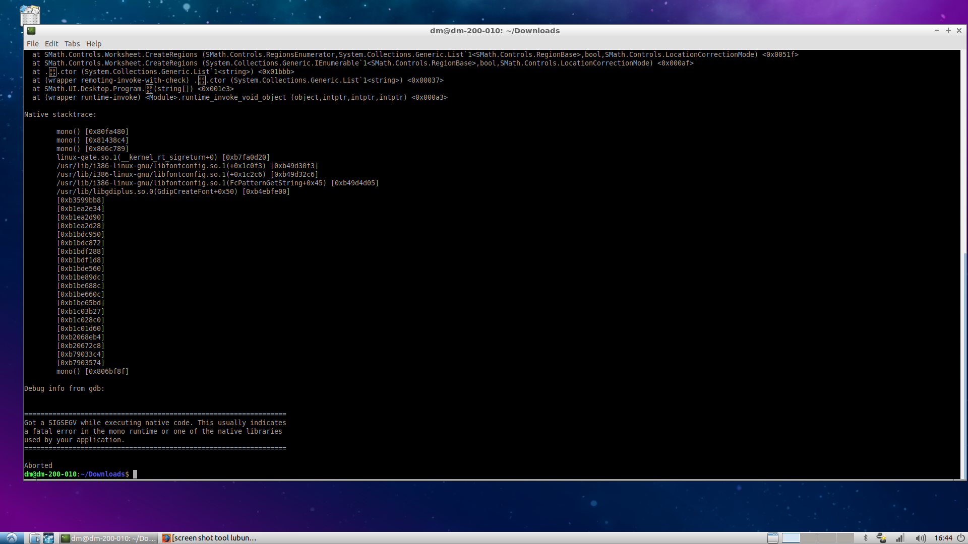

In my struggles to get it up and running since my original post, I installed some fonts. I see that my error messages have now changed to the same as what you get:
(cli:32108): Gtk-WARNING **: 08:04:17.818: Unable to locate theme engine in module_path: "adwaita",
(cli:32108): Gtk-WARNING **: 08:04:17.824: Unable to locate theme engine in module_path: "adwaita",
- [AppDir] SpecialFunctions 1.12.6839.38235 (4 ms.)
- [AppDir] HTMLFileType 1.14.6839.38235 (1 ms.)
- [AppDir] PlotRegion 1.11.6839.38235 (4 ms.)
- [AppDir] XMCDFileType 1.12.6839.38235 (0 ms.)
Stacktrace:
  at (wrapper managed-to-native) System.Drawing.GDIPlus.GdipCreateFont (intptr,single,System.Drawing.FontStyle,System.Drawing.GraphicsUnit,intptr& <0x00087>
  at System.Drawing.Font..ctor (System.Drawing.FontFamily,single,System.Drawing.FontStyle,System.Drawing.GraphicsUnit,byte,bool) <0x000b7>
  at (wrapper remoting-invoke-with-check) System.Drawing.Font..ctor (System.Drawing.FontFamily,single,System.Drawing.FontStyle) <0x0007b>
  at SMath.UI.DesktopGraphics.MeasureString (string,SMath.Drawing.FontInfo,single,SMath.Drawing.StringOptions) <0x000d7>
  at SMath.Controls.PaintContext.MeasureString (string,SMath.Drawing.FontInfo) <0x00056>
  at SMath.Controls.PaintContext.MeasureEquationString (string,single,SMath.Drawing.FontfaceStyle,SMath.Manager.TermType) <0x000a7>
  at SMath.Controls.PaintContext.GetSymbolByOperator (string,string&,System.Drawing.SizeF& <0x01103>
  at SMath.Controls.MathPainter.PrepareForPaint (SMath.Controls.MathRegion,SMath.Controls.PaintContext,SMath.Manager.Term[],SMath.Controls.MathAnswer,SMath.Manager.Term[],bool,int,SMath.Drawing.FontInfo,int& <0x00dcb>
  at SMath.Controls.MathRegion.Prepare (SMath.Drawing.IGraphics,SMath.Manager.PaintEventOptions) <0x002fb>
  at SMath.Controls.MathRegion.PrePainter () <0x00013>
  at SMath.Controls.RegionBase.InitLayout () <0x002b9>
  at SMath.Controls.Worksheet.ElementCreater (SMath.Controls.RegionBase,bool,bool,bool) <0x002a9>
  at SMath.Controls.Worksheet.CreateRegions (System.Collections.Generic.IEnumerable`1<SMath.Controls.RegionBase>,bool,SMath.Controls.LocationCorrectionMode) <0x006a7>
  at ...ctor (System.Collections.Generic.List`1<string> <0x0208b>
  at (wrapper remoting-invoke-with-check) ...ctor (System.Collections.Generic.List`1<string> <0x00043>
  at SMath.UI.Desktop.Program. (string[]) <0x0026b>
  at (wrapper runtime-invoke) <Module>.runtime_invoke_void_object (object,intptr,intptr,intptr) <0x000d1>
Native stacktrace:
        /usr/bin/cli(+0xc8514) [0x55af89ff9514]
        /usr/bin/cli(+0x1217ce) [0x55af8a0527ce]
        /usr/bin/cli(+0x3d7e3) [0x55af89f6e7e3]
        /lib/x86_64-linux-gnu/libpthread.so.0(+0x12890) [0x7fe735f52890]
        /usr/lib/x86_64-linux-gnu/libfontconfig.so.1(+0x1ceed) [0x7fe7300ebeed]
        /usr/lib/x86_64-linux-gnu/libfontconfig.so.1(+0x1d092) [0x7fe7300ec092]
        /usr/lib/x86_64-linux-gnu/libfontconfig.so.1(FcPatternGetString+0x44) [0x7fe7300ed844]
        /usr/lib/libgdiplus.so.0(GdipCreateFont+0x59) [0x7fe73176e2d9]
        [0x41c3dd78]
Debug info from gdb:
[New LWP 32110]
[New LWP 32111]
[New LWP 32114]
[Thread debugging using libthread_db enabled]
Using host libthread_db library "/lib/x86_64-linux-gnu/libthread_db.so.1".
0x00007fe735f5223a in __waitpid (pid=32117, stat_loc=0x7fe7369ff27c, options=0) at ../sysdeps/unix/sysv/linux/waitpid.c:30
30      ../sysdeps/unix/sysv/linux/waitpid.c: No such file or directory.
  Id   Target Id         Frame
* 1    Thread 0x7fe736ae1780 (LWP 32108) "Main" 0x00007fe735f5223a in __waitpid (pid=32117, stat_loc=0x7fe7369ff27c, options=0) at ../sysdeps/unix/sysv/linux/waitpid.c:30
  2    Thread 0x7fe734fff700 (LWP 32110) "SGen worker" 0x00007fe735f4d9f3 in futex_wait_cancelable (private=<optimized out>, expected=0, futex_word=0x55af8a4eca08) at ../sysdeps/unix/sysv/linux/futex-internal.h:88
  3    Thread 0x7fe735658700 (LWP 32111) "Finalizer" 0x00007fe735f506d6 in futex_abstimed_wait_cancelable (private=0, abstime=0x0, expected=0, futex_word=0x55af8a4dd640) at ../sysdeps/unix/sysv/linux/futex-internal.h:205
  4    Thread 0x7fe725f20700 (LWP 32114) "Main" 0x00007fe735a4bbf9 in __GI___poll (fds=0x7fe7350b5440, nfds=2, timeout=15) at ../sysdeps/unix/sysv/linux/poll.c:29
Thread 4 (Thread 0x7fe725f20700 (LWP 32114)):
#0  0x00007fe735a4bbf9 in __GI___poll (fds=0x7fe7350b5440, nfds=2, timeout=15) at ../sysdeps/unix/sysv/linux/poll.c:29
#1  0x0000000041c7ed86 in  ()
#2  0x0000000000000002 in  ()
#3  0x00007fe725f1ea80 in  ()
#4  0x00007fe7350b5420 in  ()
#5  0x00007fe71da8c220 in  ()
#6  0x0000000000000002 in  ()
#7  0x00007fe725f1f6a0 in  ()
#8  0x00007fe720001be0 in  ()
#9  0x00007fe725f1ea80 in  ()
#10 0x00007fe725f1ea80 in  ()
#11 0x00007fe725f1dfd0 in  ()
#12 0x00007fe7350b5440 in  ()
#13 0x00007fe725f10001 in  ()
#14 0x00007fe725f1ea80 in  ()
#15 0x0000000041c7dc00 in  ()
#16 0x00007fe7352684d8 in  ()
#17 0x00007fe725f1ea80 in  ()
#18 0x00007fe73526fd38 in  ()
#19 0x00007fe7350058a8 in  ()
#20 0x00007fe73526fd38 in  ()
#21 0x00007fe732e2e90b in System_Threading_Monitor_Enter_object_bool_ () at /usr/lib/mono/aot-cache/amd64/mscorlib.dll.so
#22 0x0000000041c6a3a4 in  ()
#23 0x00007fe700000013 in  ()
#24 0x00000000000003e2 in  ()
#25 0x0000000000000000 in  ()
Thread 3 (Thread 0x7fe735658700 (LWP 32111)):
#0  0x00007fe735f506d6 in futex_abstimed_wait_cancelable (private=0, abstime=0x0, expected=0, futex_word=0x55af8a4dd640) at ../sysdeps/unix/sysv/linux/futex-internal.h:205
#1  0x00007fe735f506d6 in do_futex_wait (sem=sem@entry=0x55af8a4dd640, abstime=0x0) at sem_waitcommon.c:111
#2  0x00007fe735f507c8 in __new_sem_wait_slow (sem=0x55af8a4dd640, abstime=0x0) at sem_waitcommon.c:181
#3  0x000055af8a115dc9 in  ()
#4  0x000055af8a0f3be1 in  ()
#5  0x000055af8a1b314a in  ()
#6  0x00007fe735f476db in start_thread (arg=0x7fe735658700) at pthread_create.c:463
#7  0x00007fe735a5888f in clone () at ../sysdeps/unix/sysv/linux/x86_64/clone.S:95
Thread 2 (Thread 0x7fe734fff700 (LWP 32110)):
#0  0x00007fe735f4d9f3 in futex_wait_cancelable (private=<optimized out>, expected=0, futex_word=0x55af8a4eca08) at ../sysdeps/unix/sysv/linux/futex-internal.h:88
#1  0x00007fe735f4d9f3 in __pthread_cond_wait_common (abstime=0x0, mutex=0x55af8a4eca20, cond=0x55af8a4ec9e0) at pthread_cond_wait.c:502
#2  0x00007fe735f4d9f3 in __pthread_cond_wait (cond=0x55af8a4ec9e0, mutex=0x55af8a4eca20) at pthread_cond_wait.c:655
#3  0x000055af8a181863 in  ()
#4  0x00007fe735f476db in start_thread (arg=0x7fe734fff700) at pthread_create.c:463
#5  0x00007fe735a5888f in clone () at ../sysdeps/unix/sysv/linux/x86_64/clone.S:95
Thread 1 (Thread 0x7fe736ae1780 (LWP 32108)):
#0  0x00007fe735f5223a in __waitpid (pid=32117, stat_loc=0x7fe7369ff27c, options=0) at ../sysdeps/unix/sysv/linux/waitpid.c:30
#1  0x000055af89ff95f0 in  ()
#2  0x000055af8a0527ce in  ()
#3  0x000055af89f6e7e3 in  ()
#4  0x00007fe735f52890 in <signal handler called> () at /lib/x86_64-linux-gnu/libpthread.so.0
#5  0x00007fe7300ebeed in  () at /usr/lib/x86_64-linux-gnu/libfontconfig.so.1
#6  0x00007fe7300ec092 in  () at /usr/lib/x86_64-linux-gnu/libfontconfig.so.1
#7  0x00007fe7300ed844 in FcPatternGetString () at /usr/lib/x86_64-linux-gnu/libfontconfig.so.1
#8  0x00007fe73176e2d9 in GdipCreateFont () at /usr/lib/libgdiplus.so.0
#9  0x0000000041c3dd78 in  ()
#10 0x00007fe71d60e1d8 in  ()
#11 0x0000000000000000 in  ()
Got a SIGSEGV while executing native code. This usually indicates
a fatal error in the mono runtime or one of the native libraries
used by your application.
Aborted

I started with 6858 and got some font errors. After installing a few fonts - e.g. Andale - I got less errors, but the application still crashed. Then I tried 6839 getting the same error messages. Version 6670 seemed to work initially even though a X11 error was reported. Only after loading the above mentioned examples SMAth crashed. Sorry, I skiped testing 6671. Today I tried 6671 on Mint. The same X11 error is still there, but Newton example loads without crashing.
6858 AND 6839 on Mint
No X11 error on startup, but GDI+ error
<<<<<<<<<<<<<<<<<<<<<<<<<<<<<< 6858 >>>>>>>>>>>>>>>>>>>>>>>>>>>>>>>>>
jro@jro19 ~/Programs/SMathMono_6858 $ mono SMathStudio_Desktop.exe
- [AppDir] SpecialFunctions 1.12.6858.3232 (6 ms.)
- [AppDir] HTMLFileType 1.14.6858.3232 (3 ms.)
- [AppDir] ImageFileType 1.11.6858.3232 (1 ms.)
- [AppDir] PictureRegion 1.10.6858.3232 (3 ms.)
- [AppDir] PlotRegion 1.11.6858.3232 (4 ms.)
- [AppDir] SMathFileType 1.11.6858.3232 (0 ms.)
- [AppDir] StandardToolboxButtons 1.1.6858.3232 (1 ms.)
- [AppDir] TextRegion 1.11.6858.3232 (1 ms.)
- [AppDir] SMath Viewer Files Plugin 1.1.6858.3242 (2 ms.)
- [AppDir] XMCDFileType 1.12.6858.3232 (1 ms.)
Unhandled Exception:
  at System.Drawing.GDIPlus.CheckStatus (Status status) <0xb491ac90 + 0x007ef> in <filename unknown>:0
  at System.Drawing.Font..ctor (System.Drawing.FontFamily family, Single emSize, FontStyle style, GraphicsUnit unit, Byte gdiCharSet, Boolean gdiVerticalFont) <0xb298d528 + 0x0009f> in <filename unknown>:0
  at System.Drawing.Font..ctor (System.Drawing.FontFamily family, Single emSize, FontStyle style) <0xb298d4d8 + 0x0003f> in <filename unknown>:0
  at (wrapper remoting-invoke-with-check) System.Drawing.Font:.ctor (System.Drawing.FontFamily,single,System.Drawing.FontStyle)
  at SMath.UI.DesktopGraphics.MeasureString (System.String text, SMath.Drawing.FontInfo font, Single width, SMath.Drawing.StringOptions format) <0xb275da00 + 0x00097> in <filename unknown>:0
  at SMath.Controls.PaintContext.MeasureString (System.String text, SMath.Drawing.FontInfo font) <0xb275d970 + 0x00041> in <filename unknown>:0
  at SMath.Controls.PaintContext.MeasureEquationString (System.String text, Single size, FontfaceStyle style, TermType type) <0xb276bc88 + 0x00087> in <filename unknown>:0
  at SMath.Controls.PaintContext.MeasureEquationString (System.String text, Single size, TermType type) <0xb276bc28 + 0x00037> in <filename unknown>:0
  at SMath.Controls.PaintContext.GetSymbolByOperator (System.String oper, System.String& text, System.Drawing.SizeF& size) <0xb276a3d8 + 0x00c27> in <filename unknown>:0
  at SMath.Controls.MathPainter.PrepareForPaint (SMath.Controls.MathRegion region, SMath.Controls.PaintContext ctx, SMath.Manager.Term[] input, SMath.Controls.MathAnswer answer, SMath.Manager.Term[] units, Boolean inputDataVisibility, Int32 currentTermIdx, SMath.Drawing.FontInfo font, System.Int32& middleLine) <0xb274e000 + 0x00c2b> in <filename unknown>:0
  at SMath.Controls.MathRegion.Prepare (IGraphics g, SMath.Manager.PaintEventOptions e) <0xb2768218 + 0x00243> in <filename unknown>:0
  at SMath.Controls.MathRegion.PrePainter () <0xb27681e0 + 0x00023> in <filename unknown>:0
  at SMath.Controls.RegionBase.InitLayout () <0xb2767f90 + 0x0022c> in <filename unknown>:0
  at SMath.Controls.Worksheet.ElementCreater (SMath.Controls.RegionBase region, System.Collections.Generic.List`1 regions, Boolean makeCurrent, Boolean batchProcessing, Boolean invalidateRequired) <0xb27656b8 + 0x001e6> in <filename unknown>:0
  at SMath.Controls.Worksheet.CreateRegions (SMath.Controls.RegionsEnumerator enumerator, System.Collections.Generic.List`1 regions, Boolean showProgress, LocationCorrectionMode locationCorrection) <0xb2764128 + 0x00517> in <filename unknown>:0
  at SMath.Controls.Worksheet.CreateRegions (IEnumerable`1 newRegions, Boolean showProgress, LocationCorrectionMode locationCorrection) <0xb2763ae0 + 0x000af> in <filename unknown>:0
  at ...ctor (System.Collections.Generic.List`1 ) <0xb2be8fb8 + 0x01bbb> in <filename unknown>:0
  at (wrapper remoting-invoke-with-check) .:.ctor (System.Collections.Generic.List`1<string>
  at SMath.UI.Desktop.Program. (System.String[] ) <0xb78dd170 + 0x001e3> in <filename unknown>:0

Just installed Lubuntu 18 LTS on an HP Stream mini and wanted to install SMath (0_99_68658). Installed mono and double clicked the .exe and is tries to load, then nothing. Tried in terminal in mono. Got a set of errors about missing font library. Tried again to do a scree capture and had a slightly different error. Attached screenshots. Also said: debug info from gdb:
Show Spoiler
mod: topic moved in the existing thread
