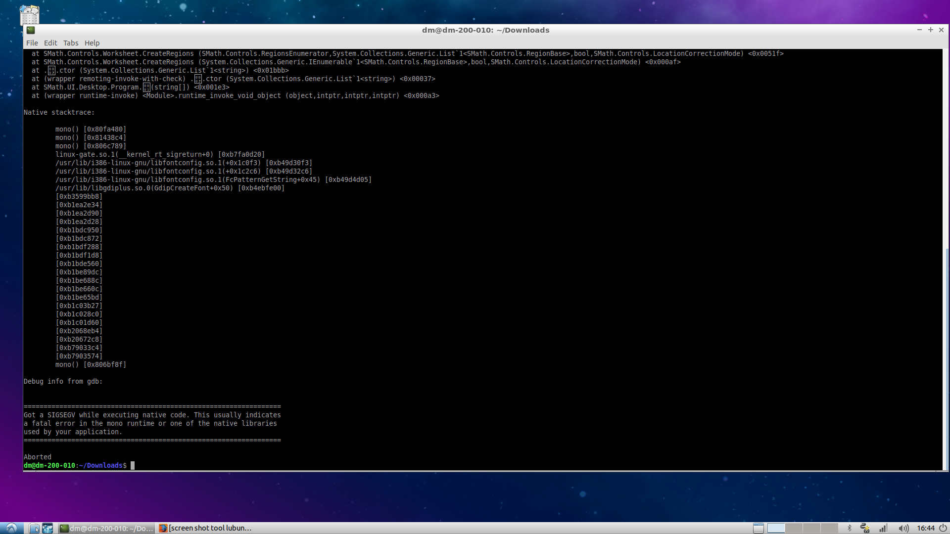

Hi, is anyone successfully using build 6839 on Linux? When I try to launch I get
[ERROR] FATAL UNHANDLED EXCEPTION: System.ArgumentException: The requested FontFamily could not be found [GDI+ status: FontFamilyNotFound]
followed by lines of what I assume are functions and memory locations where the error is thrown.
Build 6671 is still working for me, so using that in the meantime.
Any further information needed can be supplied, thanks in advance for any and all help with this.

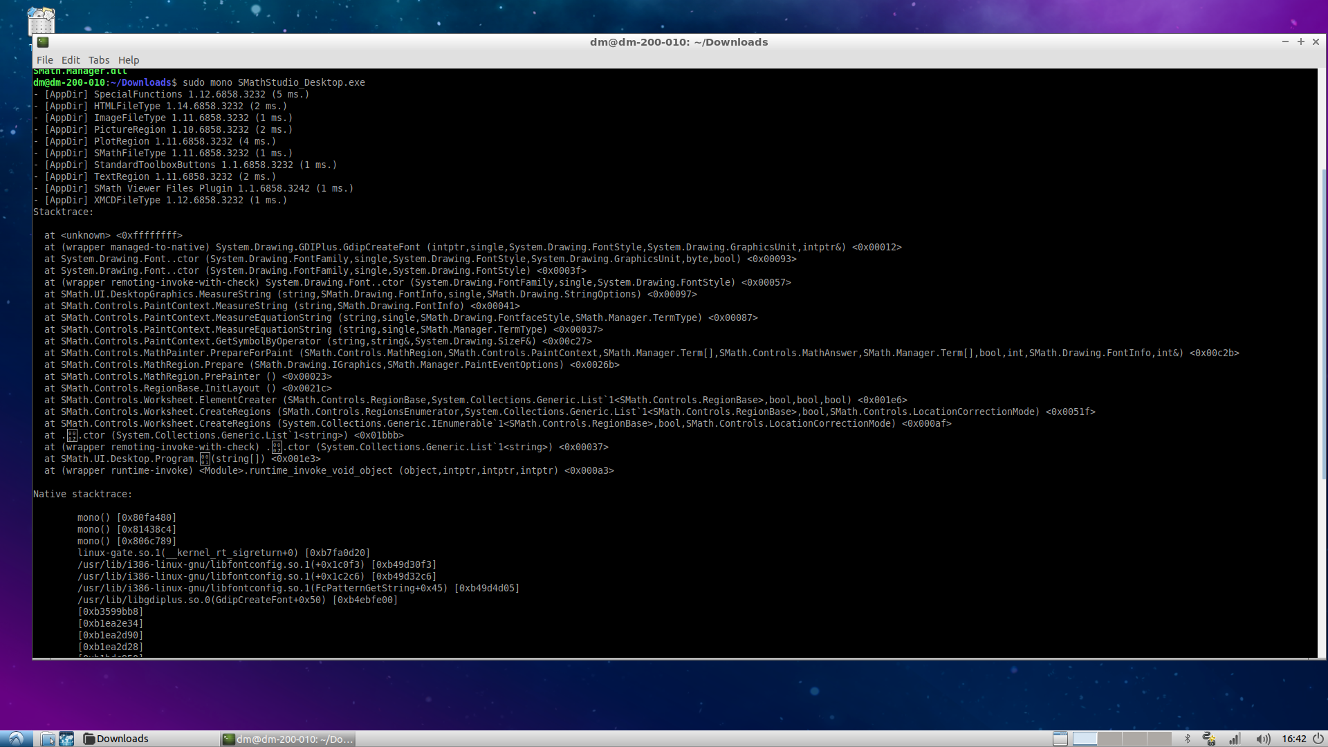

The stack trace would be really useful
I can reproduce something similar in Linux Mint, it's the same issue?
mono SMathStudio_Desktop.exe

Stacktrace:
  at <unknown> <0xffffffff>
  at (wrapper managed-to-native) System.Drawing.GDIPlus.GdipCreateFont (intptr,single,System.Drawing.FontStyle,System.Drawing.GraphicsUnit,intptr& <0xffffffff>
  at System.Drawing.Font..ctor (System.Drawing.FontFamily,single,System.Drawing.FontStyle,System.Drawing.GraphicsUnit,byte,bool) <0x000af>
  at System.Drawing.Font..ctor (System.Drawing.FontFamily,single,System.Drawing.FontStyle) <0x00047>
  at (wrapper remoting-invoke-with-check) System.Drawing.Font..ctor (System.Drawing.FontFamily,single,System.Drawing.FontStyle) <0xffffffff>
  at SMath.UI.DesktopGraphics.MeasureString (string,SMath.Drawing.FontInfo,single,SMath.Drawing.StringOptions) <0x000cf>
  at SMath.Controls.PaintContext.MeasureString (string,SMath.Drawing.FontInfo) <0x0004f>
  at SMath.Controls.PaintContext.MeasureEquationString (string,single,SMath.Drawing.FontfaceStyle,SMath.Manager.TermType) <0x00097>
  at SMath.Controls.PaintContext.MeasureEquationString (string,single,SMath.Manager.TermType) <0x0003f>
  at SMath.Controls.PaintContext.GetSymbolByOperator (string,string&,System.Drawing.SizeF& <0x00f5f>
  at SMath.Controls.MathPainter.PrepareForPaint (SMath.Controls.MathRegion,SMath.Controls.PaintContext,SMath.Manager.Term[],SMath.Controls.MathAnswer,SMath.Manager.Term[],bool,int,SMath.Drawing.FontInfo,int& <0x00c9f>
  at SMath.Controls.MathRegion.Prepare (SMath.Drawing.IGraphics,SMath.Manager.PaintEventOptions) <0x002d7>
  at SMath.Controls.MathRegion.PrePainter () <0x00017>
  at SMath.Controls.RegionBase.InitLayout () <0x002a9>
  at SMath.Controls.Worksheet.ElementCreater (SMath.Controls.RegionBase,bool,bool,bool) <0x0027d>
  at SMath.Controls.Worksheet.CreateRegions (System.Collections.Generic.IEnumerable`1<SMath.Controls.RegionBase>,bool,SMath.Controls.LocationCorrectionMode) <0x0064f>
  at ...ctor (System.Collections.Generic.List`1<string> <0x01e4b>
  at (wrapper remoting-invoke-with-check) ...ctor (System.Collections.Generic.List`1<string> <0xffffffff>
  at SMath.UI.Desktop.Program. (string[]) <0x0024b>
  at (wrapper runtime-invoke) <Module>.runtime_invoke_void_object (object,intptr,intptr,intptr) <0xffffffff>
Native stacktrace:
	mono() [0x4b73d8]
	mono() [0x50f13b]
	mono() [0x423d22]
	/lib/x86_64-linux-gnu/libpthread.so.0(+0x10330) [0x7fa34a779330]
	/usr/lib/x86_64-linux-gnu/libfontconfig.so.1(+0x1b2ed) [0x7fa34552f2ed]
	/usr/lib/x86_64-linux-gnu/libfontconfig.so.1(+0x1ba29) [0x7fa34552fa29]
	/usr/lib/x86_64-linux-gnu/libfontconfig.so.1(+0x1c798) [0x7fa345530798]
	/usr/lib/x86_64-linux-gnu/libfontconfig.so.1(+0x1c980) [0x7fa345530980]
	/usr/lib/libgdiplus.so.0(GdipCreateFont+0x62) [0x7fa346b562c2]
	[0x415b2943]

Yes.
In my struggles to get it up and running since my original post, I installed some fonts. I see that my error messages have now changed to the same as what you get:
(cli:32108): Gtk-WARNING **: 08:04:17.818: Unable to locate theme engine in module_path: "adwaita",
(cli:32108): Gtk-WARNING **: 08:04:17.824: Unable to locate theme engine in module_path: "adwaita",

a fatal error in the mono runtime or one of the native libraries
used by your application.
Aborted

I started with 6858 and got some font errors. After installing a few fonts - e.g. Andale - I got less errors, but the application still crashed. Then I tried 6839 getting the same error messages. Version 6670 seemed to work initially even though a X11 error was reported. Only after loading the above mentioned examples SMAth crashed. Sorry, I skiped testing 6671. Today I tried 6671 on Mint. The same X11 error is still there, but Newton example loads without crashing.
6858 AND 6839 on Mint
No X11 error on startup, but GDI+ error
<<<<<<<<<<<<<<<<<<<<<<<<<<<<<< 6858 >>>>>>>>>>>>>>>>>>>>>>>>>>>>>>>>>
jro@jro19 ~/Programs/SMathMono_6858 $ mono SMathStudio_Desktop.exe
- [AppDir] SpecialFunctions 1.12.6858.3232 (6 ms.)
- [AppDir] HTMLFileType 1.14.6858.3232 (3 ms.)
- [AppDir] ImageFileType 1.11.6858.3232 (1 ms.)
- [AppDir] PictureRegion 1.10.6858.3232 (3 ms.)
- [AppDir] PlotRegion 1.11.6858.3232 (4 ms.)
- [AppDir] SMathFileType 1.11.6858.3232 (0 ms.)
- [AppDir] StandardToolboxButtons 1.1.6858.3232 (1 ms.)
- [AppDir] TextRegion 1.11.6858.3232 (1 ms.)
- [AppDir] SMath Viewer Files Plugin 1.1.6858.3242 (2 ms.)
- [AppDir] XMCDFileType 1.12.6858.3232 (1 ms.)
Unhandled Exception:
  at System.Drawing.GDIPlus.CheckStatus (Status status) <0xb491ac90 + 0x007ef> in <filename unknown>:0
  at System.Drawing.Font..ctor (System.Drawing.FontFamily family, Single emSize, FontStyle style, GraphicsUnit unit, Byte gdiCharSet, Boolean gdiVerticalFont) <0xb298d528 + 0x0009f> in <filename unknown>:0
  at System.Drawing.Font..ctor (System.Drawing.FontFamily family, Single emSize, FontStyle style) <0xb298d4d8 + 0x0003f> in <filename unknown>:0
  at (wrapper remoting-invoke-with-check) System.Drawing.Font:.ctor (System.Drawing.FontFamily,single,System.Drawing.FontStyle)
  at SMath.UI.DesktopGraphics.MeasureString (System.String text, SMath.Drawing.FontInfo font, Single width, SMath.Drawing.StringOptions format) <0xb275da00 + 0x00097> in <filename unknown>:0
  at SMath.Controls.PaintContext.MeasureString (System.String text, SMath.Drawing.FontInfo font) <0xb275d970 + 0x00041> in <filename unknown>:0
  at SMath.Controls.PaintContext.MeasureEquationString (System.String text, Single size, FontfaceStyle style, TermType type) <0xb276bc88 + 0x00087> in <filename unknown>:0
  at SMath.Controls.PaintContext.MeasureEquationString (System.String text, Single size, TermType type) <0xb276bc28 + 0x00037> in <filename unknown>:0
  at SMath.Controls.PaintContext.GetSymbolByOperator (System.String oper, System.String& text, System.Drawing.SizeF& size) <0xb276a3d8 + 0x00c27> in <filename unknown>:0
  at SMath.Controls.MathPainter.PrepareForPaint (SMath.Controls.MathRegion region, SMath.Controls.PaintContext ctx, SMath.Manager.Term[] input, SMath.Controls.MathAnswer answer, SMath.Manager.Term[] units, Boolean inputDataVisibility, Int32 currentTermIdx, SMath.Drawing.FontInfo font, System.Int32& middleLine) <0xb274e000 + 0x00c2b> in <filename unknown>:0
  at SMath.Controls.MathRegion.Prepare (IGraphics g, SMath.Manager.PaintEventOptions e) <0xb2768218 + 0x00243> in <filename unknown>:0
  at SMath.Controls.MathRegion.PrePainter () <0xb27681e0 + 0x00023> in <filename unknown>:0
  at SMath.Controls.RegionBase.InitLayout () <0xb2767f90 + 0x0022c> in <filename unknown>:0
  at SMath.Controls.Worksheet.ElementCreater (SMath.Controls.RegionBase region, System.Collections.Generic.List`1 regions, Boolean makeCurrent, Boolean batchProcessing, Boolean invalidateRequired) <0xb27656b8 + 0x001e6> in <filename unknown>:0
  at SMath.Controls.Worksheet.CreateRegions (SMath.Controls.RegionsEnumerator enumerator, System.Collections.Generic.List`1 regions, Boolean showProgress, LocationCorrectionMode locationCorrection) <0xb2764128 + 0x00517> in <filename unknown>:0
  at SMath.Controls.Worksheet.CreateRegions (IEnumerable`1 newRegions, Boolean showProgress, LocationCorrectionMode locationCorrection) <0xb2763ae0 + 0x000af> in <filename unknown>:0
  at ...ctor (System.Collections.Generic.List`1 ) <0xb2be8fb8 + 0x01bbb> in <filename unknown>:0
  at (wrapper remoting-invoke-with-check) .:.ctor (System.Collections.Generic.List`1<string>
  at SMath.UI.Desktop.Program. (System.String[] ) <0xb78dd170 + 0x001e3> in <filename unknown>:0

Just installed Lubuntu 18 LTS on an HP Stream mini and wanted to install SMath (0_99_68658). Installed mono and double clicked the .exe and is tries to load, then nothing. Tried in terminal in mono. Got a set of errors about missing font library. Tried again to do a scree capture and had a slightly different error. Attached screenshots. Also said: debug info from gdb:
Got a SIGSEGV while executing native code. This usually indicates
Show Spoiler
mod: topic moved in the existing thread
