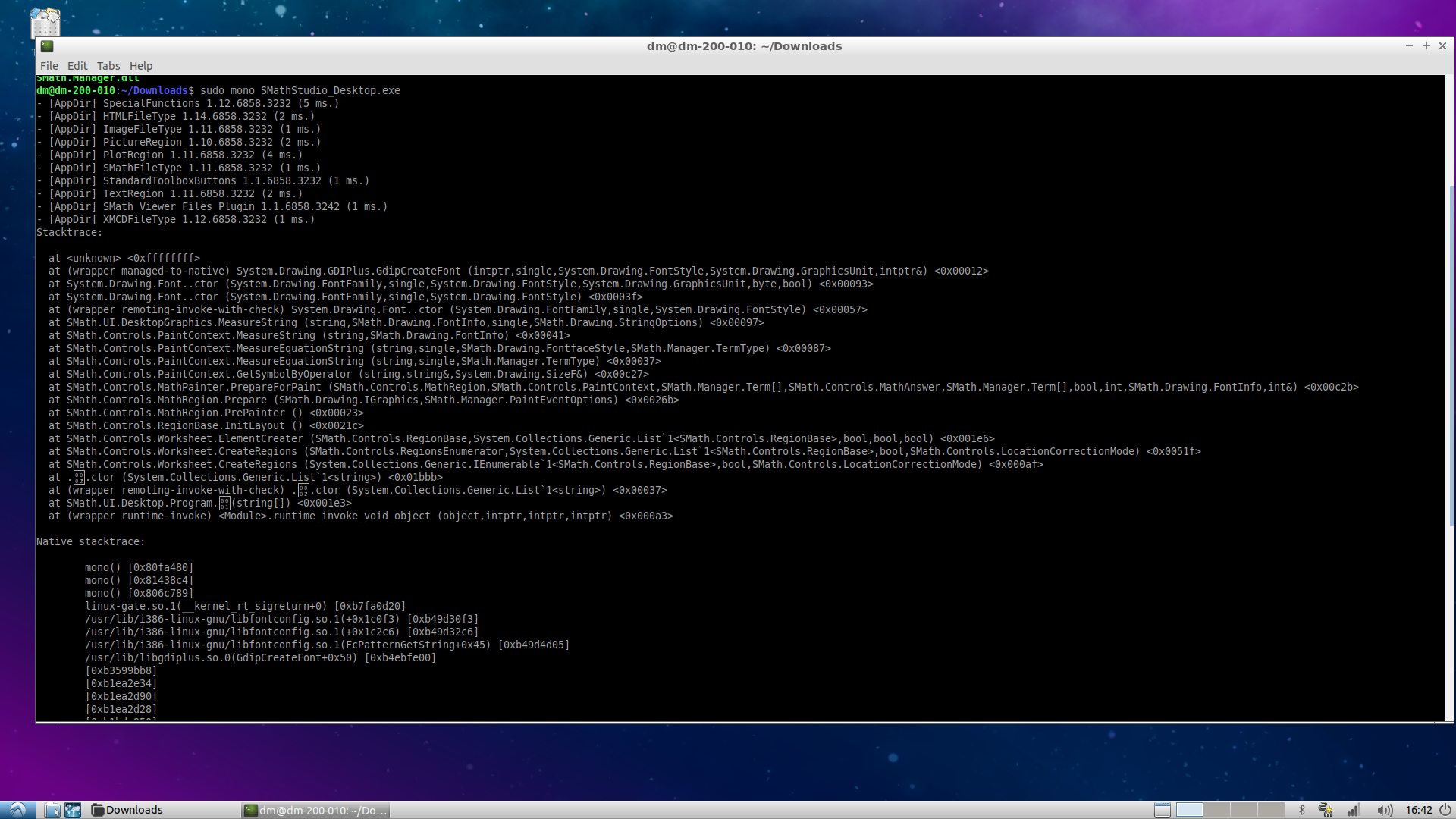

#2 Опубликовано: 15.10.2018 06:01:10
Hello [userlink]Eric Myers[/userlink],
Thank you for reporting the bug
Any further information needed can be supplied, thanks in advance for any and all help with this.
The stack trace would be really useful
I can reproduce something similar in Linux Mint, it's the same issue?
mono SMathStudio_Desktop.exe
- [AppDir] SpecialFunctions 1.12.6839.38235 (9 ms.)
- [AppDir] HTMLFileType 1.14.6839.38235 (3 ms.)
- [AppDir] ImageFileType 1.11.6839.38235 (0 ms.)
- [AppDir] PictureRegion 1.10.6839.38235 (1 ms.)
- [AppDir] PlotRegion 1.11.6839.38235 (9 ms.)
- [AppDir] SMathFileType 1.11.6839.38235 (0 ms.)
- [AppDir] StandardToolboxButtons 1.1.6839.38235 (0 ms.)
- [AppDir] TextRegion 1.11.6839.38235 (0 ms.)
- [AppDir] SMath Viewer Files Plugin 1.1.6839.38249 (0 ms.)
- [AppDir] XMCDFileType 1.12.6839.38235 (1 ms.)
Stacktrace:
  at <unknown> <0xffffffff>
  at (wrapper managed-to-native) System.Drawing.GDIPlus.GdipCreateFont (intptr,single,System.Drawing.FontStyle,System.Drawing.GraphicsUnit,intptr& <0xffffffff>
  at System.Drawing.Font..ctor (System.Drawing.FontFamily,single,System.Drawing.FontStyle,System.Drawing.GraphicsUnit,byte,bool) <0x000af>
  at System.Drawing.Font..ctor (System.Drawing.FontFamily,single,System.Drawing.FontStyle) <0x00047>
  at (wrapper remoting-invoke-with-check) System.Drawing.Font..ctor (System.Drawing.FontFamily,single,System.Drawing.FontStyle) <0xffffffff>
  at SMath.UI.DesktopGraphics.MeasureString (string,SMath.Drawing.FontInfo,single,SMath.Drawing.StringOptions) <0x000cf>
  at SMath.Controls.PaintContext.MeasureString (string,SMath.Drawing.FontInfo) <0x0004f>
  at SMath.Controls.PaintContext.MeasureEquationString (string,single,SMath.Drawing.FontfaceStyle,SMath.Manager.TermType) <0x00097>
  at SMath.Controls.PaintContext.MeasureEquationString (string,single,SMath.Manager.TermType) <0x0003f>
  at SMath.Controls.PaintContext.GetSymbolByOperator (string,string&,System.Drawing.SizeF& <0x00f5f>
  at SMath.Controls.MathPainter.PrepareForPaint (SMath.Controls.MathRegion,SMath.Controls.PaintContext,SMath.Manager.Term[],SMath.Controls.MathAnswer,SMath.Manager.Term[],bool,int,SMath.Drawing.FontInfo,int& <0x00c9f>
  at SMath.Controls.MathRegion.Prepare (SMath.Drawing.IGraphics,SMath.Manager.PaintEventOptions) <0x002d7>
  at SMath.Controls.MathRegion.PrePainter () <0x00017>
  at SMath.Controls.RegionBase.InitLayout () <0x002a9>
  at SMath.Controls.Worksheet.ElementCreater (SMath.Controls.RegionBase,bool,bool,bool) <0x0027d>
  at SMath.Controls.Worksheet.CreateRegions (System.Collections.Generic.IEnumerable`1<SMath.Controls.RegionBase>,bool,SMath.Controls.LocationCorrectionMode) <0x0064f>
  at ...ctor (System.Collections.Generic.List`1<string> <0x01e4b>
  at (wrapper remoting-invoke-with-check) ...ctor (System.Collections.Generic.List`1<string> <0xffffffff>
  at SMath.UI.Desktop.Program. (string[]) <0x0024b>
  at (wrapper runtime-invoke) <Module>.runtime_invoke_void_object (object,intptr,intptr,intptr) <0xffffffff>
Native stacktrace:
	mono() [0x4b73d8]
	mono() [0x50f13b]
	mono() [0x423d22]
	/lib/x86_64-linux-gnu/libpthread.so.0(+0x10330) [0x7fa34a779330]
	/usr/lib/x86_64-linux-gnu/libfontconfig.so.1(+0x1b2ed) [0x7fa34552f2ed]
	/usr/lib/x86_64-linux-gnu/libfontconfig.so.1(+0x1ba29) [0x7fa34552fa29]
	/usr/lib/x86_64-linux-gnu/libfontconfig.so.1(+0x1c798) [0x7fa345530798]
	/usr/lib/x86_64-linux-gnu/libfontconfig.so.1(+0x1c980) [0x7fa345530980]
	/usr/lib/libgdiplus.so.0(GdipCreateFont+0x62) [0x7fa346b562c2]
	[0x415b2943]

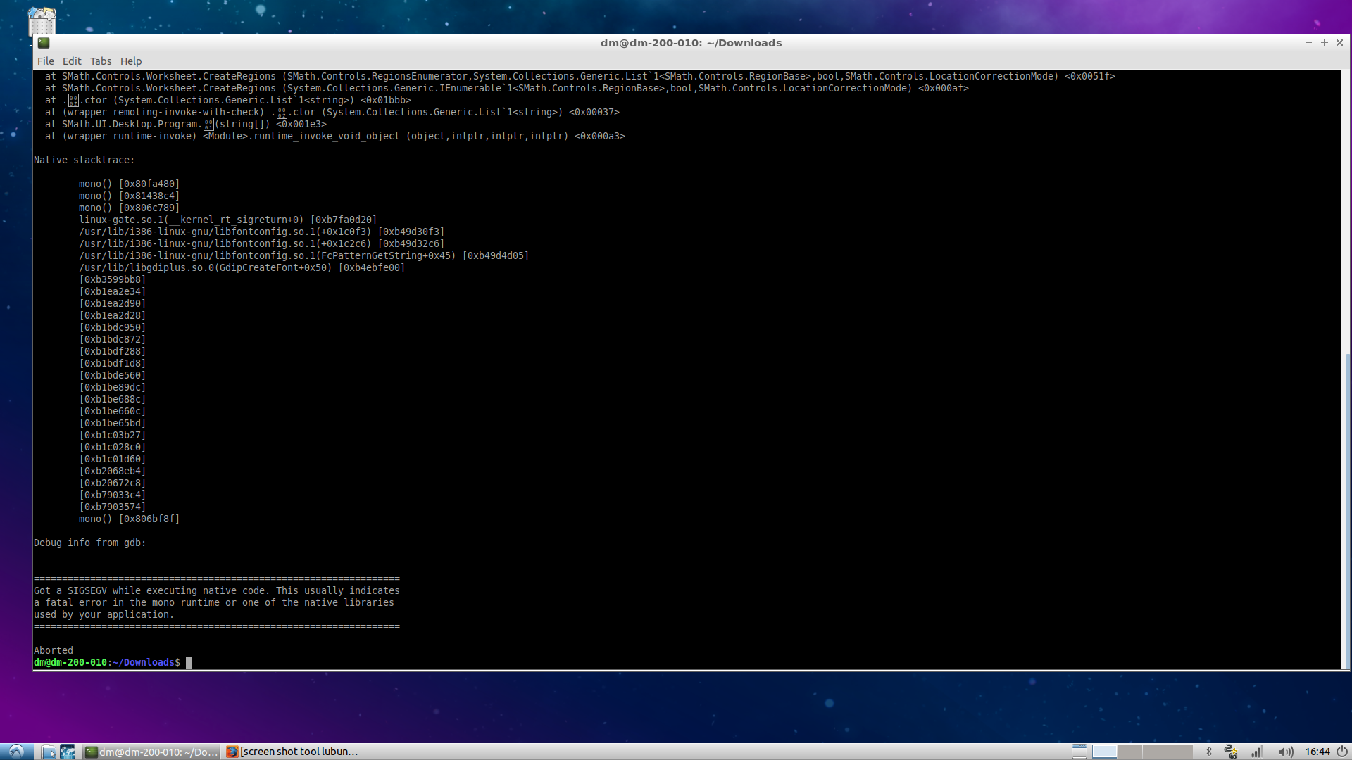

#3 Опубликовано: 15.10.2018 10:14:48
Anders or Eric
Anders or Eric
4 сообщений из 40 понравились пользователям.
Yes.
In my struggles to get it up and running since my original post, I installed some fonts. I see that my error messages have now changed to the same as what you get:
(cli:32108): Gtk-WARNING **: 08:04:17.818: Unable to locate theme engine in module_path: "adwaita",
(cli:32108): Gtk-WARNING **: 08:04:17.824: Unable to locate theme engine in module_path: "adwaita",
- [AppDir] SpecialFunctions 1.12.6839.38235 (4 ms.)
- [AppDir] HTMLFileType 1.14.6839.38235 (1 ms.)
- [AppDir] PlotRegion 1.11.6839.38235 (4 ms.)
- [AppDir] XMCDFileType 1.12.6839.38235 (0 ms.)
Stacktrace:
  at (wrapper managed-to-native) System.Drawing.GDIPlus.GdipCreateFont (intptr,single,System.Drawing.FontStyle,System.Drawing.GraphicsUnit,intptr& <0x00087>
  at System.Drawing.Font..ctor (System.Drawing.FontFamily,single,System.Drawing.FontStyle,System.Drawing.GraphicsUnit,byte,bool) <0x000b7>
  at (wrapper remoting-invoke-with-check) System.Drawing.Font..ctor (System.Drawing.FontFamily,single,System.Drawing.FontStyle) <0x0007b>
  at SMath.UI.DesktopGraphics.MeasureString (string,SMath.Drawing.FontInfo,single,SMath.Drawing.StringOptions) <0x000d7>
  at SMath.Controls.PaintContext.MeasureString (string,SMath.Drawing.FontInfo) <0x00056>
  at SMath.Controls.PaintContext.MeasureEquationString (string,single,SMath.Drawing.FontfaceStyle,SMath.Manager.TermType) <0x000a7>
  at SMath.Controls.PaintContext.GetSymbolByOperator (string,string&,System.Drawing.SizeF& <0x01103>
  at SMath.Controls.MathPainter.PrepareForPaint (SMath.Controls.MathRegion,SMath.Controls.PaintContext,SMath.Manager.Term[],SMath.Controls.MathAnswer,SMath.Manager.Term[],bool,int,SMath.Drawing.FontInfo,int& <0x00dcb>
  at SMath.Controls.MathRegion.Prepare (SMath.Drawing.IGraphics,SMath.Manager.PaintEventOptions) <0x002fb>
  at SMath.Controls.MathRegion.PrePainter () <0x00013>
  at SMath.Controls.RegionBase.InitLayout () <0x002b9>
  at SMath.Controls.Worksheet.ElementCreater (SMath.Controls.RegionBase,bool,bool,bool) <0x002a9>
  at SMath.Controls.Worksheet.CreateRegions (System.Collections.Generic.IEnumerable`1<SMath.Controls.RegionBase>,bool,SMath.Controls.LocationCorrectionMode) <0x006a7>
  at ...ctor (System.Collections.Generic.List`1<string> <0x0208b>
  at (wrapper remoting-invoke-with-check) ...ctor (System.Collections.Generic.List`1<string> <0x00043>
  at SMath.UI.Desktop.Program. (string[]) <0x0026b>
  at (wrapper runtime-invoke) <Module>.runtime_invoke_void_object (object,intptr,intptr,intptr) <0x000d1>
Native stacktrace:
        /usr/bin/cli(+0xc8514) [0x55af89ff9514]
        /usr/bin/cli(+0x1217ce) [0x55af8a0527ce]
        /usr/bin/cli(+0x3d7e3) [0x55af89f6e7e3]
        /lib/x86_64-linux-gnu/libpthread.so.0(+0x12890) [0x7fe735f52890]
        /usr/lib/x86_64-linux-gnu/libfontconfig.so.1(+0x1ceed) [0x7fe7300ebeed]
        /usr/lib/x86_64-linux-gnu/libfontconfig.so.1(+0x1d092) [0x7fe7300ec092]
        /usr/lib/x86_64-linux-gnu/libfontconfig.so.1(FcPatternGetString+0x44) [0x7fe7300ed844]
        /usr/lib/libgdiplus.so.0(GdipCreateFont+0x59) [0x7fe73176e2d9]
        [0x41c3dd78]

Got a SIGSEGV while executing native code. This usually indicates
a fatal error in the mono runtime or one of the native libraries
used by your application.
Aborted

I started with 6858 and got some font errors. After installing a few fonts - e.g. Andale - I got less errors, but the application still crashed. Then I tried 6839 getting the same error messages. Version 6670 seemed to work initially even though a X11 error was reported. Only after loading the above mentioned examples SMAth crashed. Sorry, I skiped testing 6671. Today I tried 6671 on Mint. The same X11 error is still there, but Newton example loads without crashing.
6858 AND 6839 on Mint
No X11 error on startup, but GDI+ error
<<<<<<<<<<<<<<<<<<<<<<<<<<<<<< 6858 >>>>>>>>>>>>>>>>>>>>>>>>>>>>>>>>>

Unhandled Exception:
System.ArgumentException: The requested FontFamily could not be found [GDI+ status: FontFamilyNotFound]
  at System.Drawing.GDIPlus.CheckStatus (Status status) <0xb491ac90 + 0x007ef> in <filename unknown>:0
  at System.Drawing.Font..ctor (System.Drawing.FontFamily family, Single emSize, FontStyle style, GraphicsUnit unit, Byte gdiCharSet, Boolean gdiVerticalFont) <0xb298d528 + 0x0009f> in <filename unknown>:0
  at System.Drawing.Font..ctor (System.Drawing.FontFamily family, Single emSize, FontStyle style) <0xb298d4d8 + 0x0003f> in <filename unknown>:0
  at (wrapper remoting-invoke-with-check) System.Drawing.Font:.ctor (System.Drawing.FontFamily,single,System.Drawing.FontStyle)
  at SMath.UI.DesktopGraphics.MeasureString (System.String text, SMath.Drawing.FontInfo font, Single width, SMath.Drawing.StringOptions format) <0xb275da00 + 0x00097> in <filename unknown>:0
  at SMath.Controls.PaintContext.MeasureString (System.String text, SMath.Drawing.FontInfo font) <0xb275d970 + 0x00041> in <filename unknown>:0

dmmartinez
dmmartinez
Just installed Lubuntu 18 LTS on an HP Stream mini and wanted to install SMath (0_99_68658). Installed mono and double clicked the .exe and is tries to load, then nothing. Tried in terminal in mono. Got a set of errors about missing font library. Tried again to do a scree capture and had a slightly different error. Attached screenshots. Also said: debug info from gdb:
Показать спойлер
