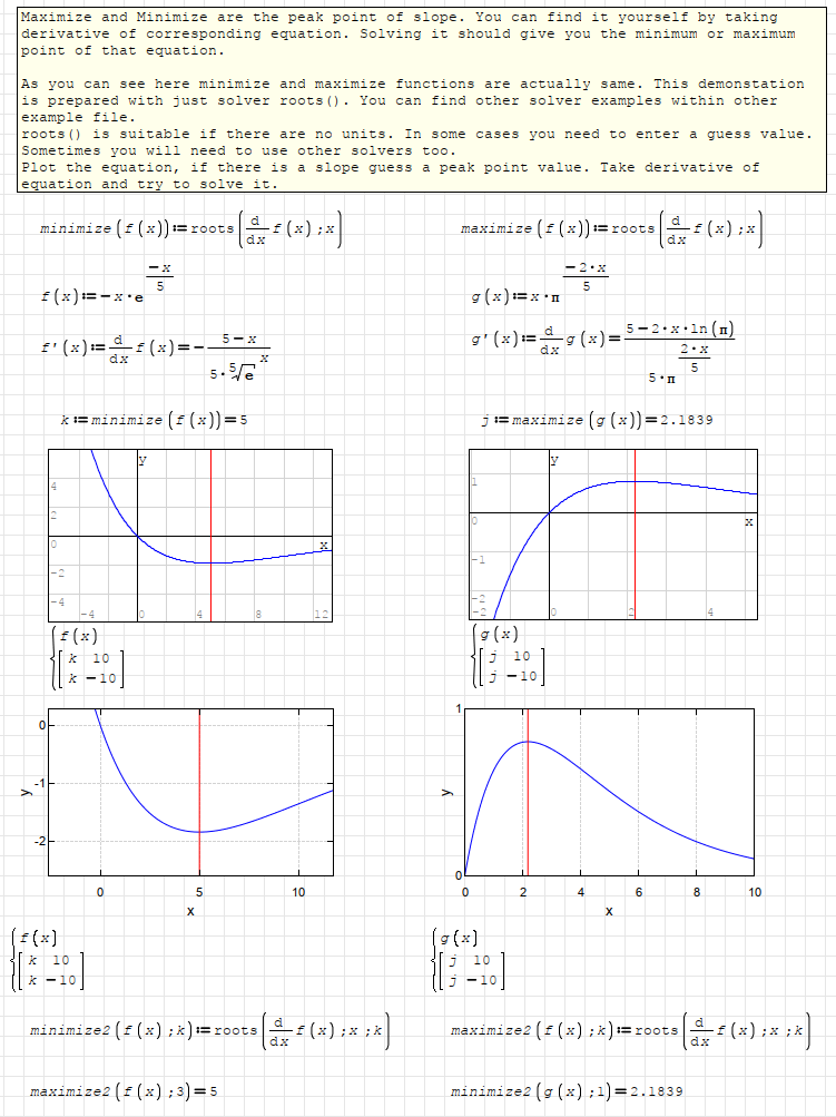

You can write your own functions.
maximize and minimize are peak points of slope.
Take derivative of equation, solve it.
Check the examples below.
maximize_minimize.sm (16.48 KiB) downloaded 1156 time(s).
maximize_minimize with different solvers.sm (28.5 KiB) downloaded 1161 time(s).

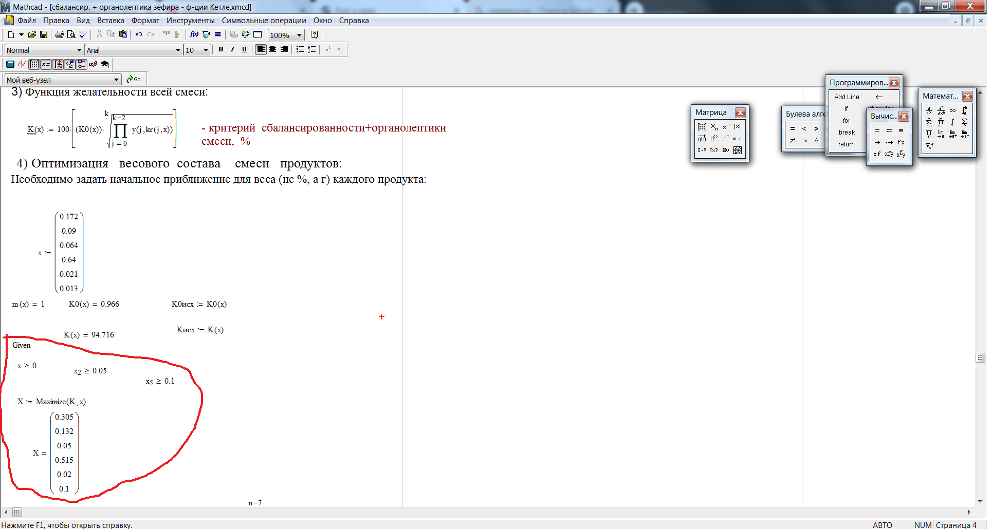

I have a program in MathCad,the problem is that the marshmallow recipe is being optimized here,
I need a maximization function to find the maximum value of each ingredient.
sbalansir. + organoleptika zefira - f-cii Ketle.xls (21 KiB) downloaded 794 time(s).
the exel file contains the values ​​of each marshmallow component that are used in the task.
sbalansir. + organoleptika zefira - f-cii Ketle.xmcd (250.52 KiB) downloaded 1180 time(s).
The whole problem is that the function K(x) is six-dimensional and there is no idea how to find its derivatives.
I need to do the same in Smath Studio, but there are no Given / Maximize / Minimize functions in Smath,
I don't know how to implement this.

Unfortunately, this does not work with my function, because it is more complex than yours.

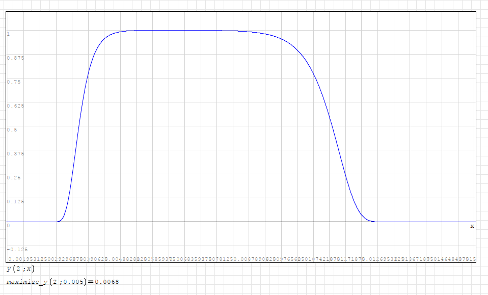

Here is the first solution for your graphics. Rest are in the example.
This is an ugly and fast solution compiled in a haste.
I am pretty sure someone in the forum will come with a more classy method.
diplomnayaRabota_rev.sm (40.34 KiB) downloaded 1123 time(s).

Thanks for your feedback , but I need to calculate maximize from the function K(x),
not from y(j, x).
Check this pdf Mathcad file:
Mathcad - sbalansir. + organoleptika zefira - f-cii Ketle.pdf (245.08 KiB) downloaded 677 time(s).
After the function K (x), the vector x is given as the initial approximation
and after that the Given and Miximize functions are used for the K(x) function.
I need to get vector X in Smath.
p.s sorry for my bad eng

Thanks for your corrections , but the main question was how to get this vector X without the Given and Maximize functions,
because it's obtained from these functions: "X: = Maximize (K, x) ?

Hi, I didn't really understand how you made such a function for the previous maximize problem,
I wanted to ask you to help me solve a simpler problem on this topic.
Milk shake optimization.sm (17.76 KiB) downloaded 1132 time(s).
pdf Mathcad file:
Mathcad - mag.2020 Aleksandr Baranov Optimizacija molochnogo koktejjlja.pdf (99.43 KiB) downloaded 726 time(s).
In this program, I need to repeat everything in the same way as in the screenshots of MathCad, i attached them to Smath.
I would be very grateful if you could help me.
If you have any questions, ask, I will answer them.
