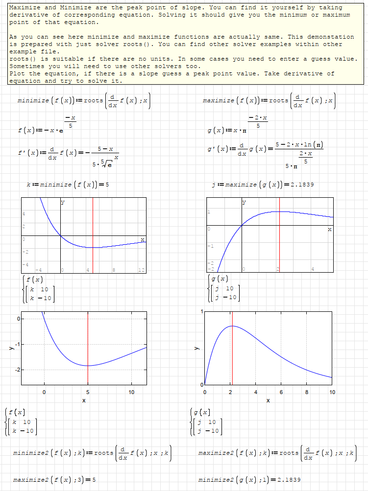

You can write your own functions.
maximize and minimize are peak points of slope.
Take derivative of equation, solve it.
Check the examples below.
maximize_minimize.sm (16,48 КиБ) скачан 1156 раз(а).
maximize_minimize with different solvers.sm (28,5 КиБ) скачан 1161 раз(а).

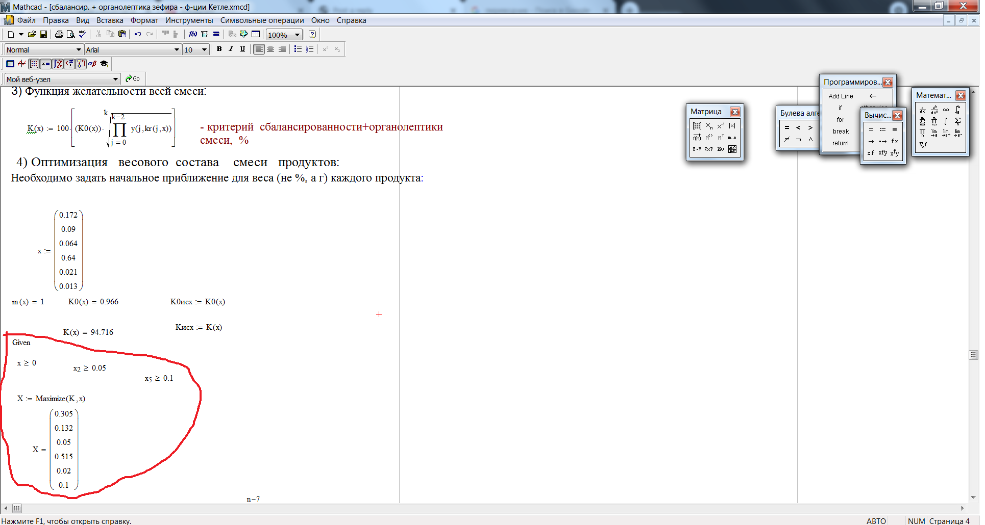

I have a program in MathCad,the problem is that the marshmallow recipe is being optimized here,
I need a maximization function to find the maximum value of each ingredient.
sbalansir. + organoleptika zefira - f-cii Ketle.xls (21 КиБ) скачан 794 раз(а).
the exel file contains the values ​​of each marshmallow component that are used in the task.
sbalansir. + organoleptika zefira - f-cii Ketle.xmcd (250,52 КиБ) скачан 1180 раз(а).
The whole problem is that the function K(x) is six-dimensional and there is no idea how to find its derivatives.
I need to do the same in Smath Studio, but there are no Given / Maximize / Minimize functions in Smath,
I don't know how to implement this.

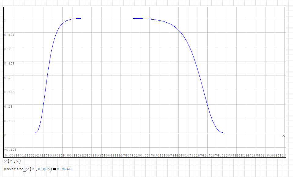

Here is the first solution for your graphics. Rest are in the example.
This is an ugly and fast solution compiled in a haste.
I am pretty sure someone in the forum will come with a more classy method.
diplomnayaRabota_rev.sm (40,34 КиБ) скачан 1123 раз(а).

Thanks for your feedback , but I need to calculate maximize from the function K(x),
not from y(j, x).
Check this pdf Mathcad file:
Mathcad - sbalansir. + organoleptika zefira - f-cii Ketle.pdf (245,08 КиБ) скачан 677 раз(а).
After the function K (x), the vector x is given as the initial approximation
and after that the Given and Miximize functions are used for the K(x) function.
I need to get vector X in Smath.
p.s sorry for my bad eng

Thanks for your corrections , but the main question was how to get this vector X without the Given and Maximize functions,
because it's obtained from these functions: "X: = Maximize (K, x) ?
