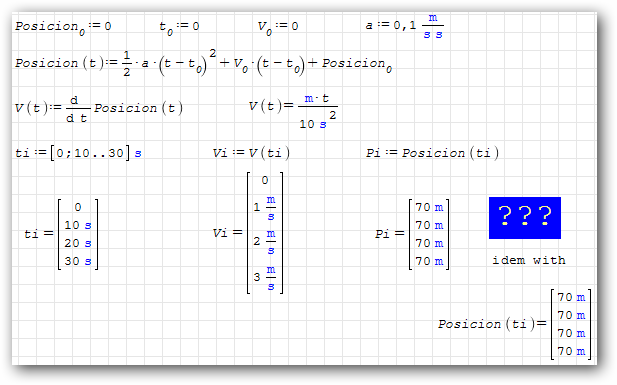

However, by analyzing the individual values
any solution?
#2 Posted: 8/16/2018 10:21:46 AM
127 likes in 342 posts.
You must use the "vectorize" function to execute the operation element by element of the vector "ti"

#4 Posted: 8/16/2018 1:37:25 PM
any solution?

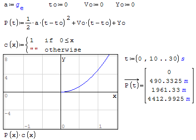

Cannonball project ...
Maths Cannonball Copy.sm (28.19 KiB) downloaded 1237 time(s).
