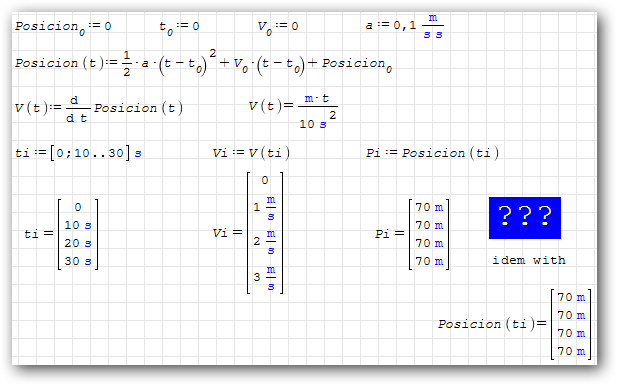

vector incorrect?
vector incorrect? - The values of the Pi vector, calculated for the previously defined function are invalid - Сообщения

However, by analyzing the individual values
any solution?

You must use the "vectorize" function to execute the operation element by element of the vector "ti"
[albumimg]1507[/albumimg]
