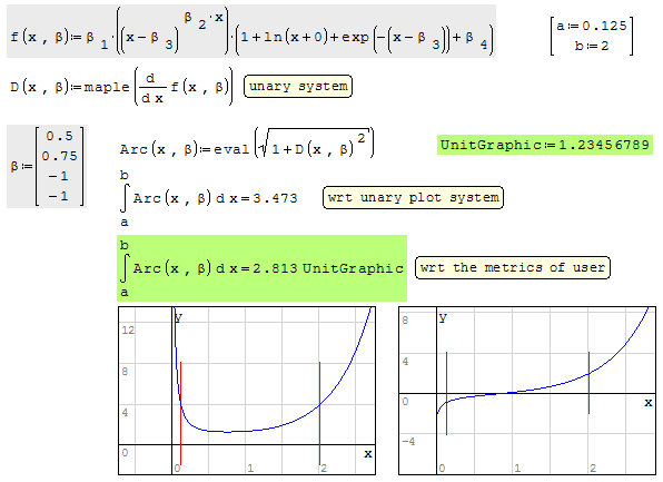

#1 Posted: 1/28/2019 4:22:38 PM
Integrate Arc Length UNARY.sm (10.12 KiB) downloaded 1164 time(s).

Hi Jean,
in which version did you prepare this example?
I use the last beta version, but I get a error 'x-not defined'
Thank you and best regards,
Andrey
#3 Posted: 2/3/2019 12:25:36 PM
It is probably because MapleTools returns β[#] instead of el(β,#)

#4 Posted: 2/3/2019 4:01:55 PM
Fridel Selitsky
Fridel Selitsky
520 likes in 451 posts.
"It is probably because MapleTools returns β[#] instead of el(β,#)"
Thank you, everything works without maple
#5 Posted: 2/3/2019 4:45:38 PM
1,555 likes in 1,867 posts.
MapleTools updated. Issue fixed.
Davide Carpi 2/3/2019 7:43:00 PM
#6 Posted: 2/3/2019 10:05:25 PM
... from Smath 6179.
As Davide points out, your latest freaks Maple !
#7 Posted: 2/4/2019 11:14:58 AM
Andrey
Andrey
1 likes in 44 posts.
Hi Jean,
thank you for the answer!
And thank Uni for adjusting of the plugin!
It works now
Best regards,
Andrey
